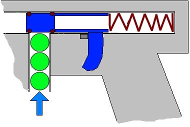

@jhalek and Poland_Spud:
Thank you for your ideas for slowing down the bolt, but I have to admit that I don't really understand them.
Here is a diagram of the current blowback (I told you it's nothing fancy JSR...), feel free to add your idea's into it.
And Poland_Spud, the return stroke is not the problem, because the mag-port is already open at this point.

nature-boy wrote:Here is a diagram of the current blowback (I told you it's nothing fancy JSR...), feel free to add your idea's into it.
Seems I'm of the same mind, but my idea was to eliminate the whole QEV/DCV setup by using an airtight o-ring detent which would remove the need for a fast valve.

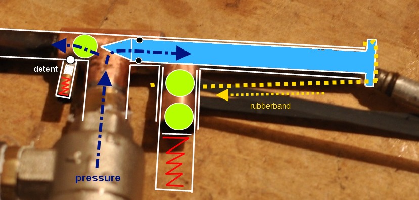

jackssmirkingrevenge wrote:my idea was to eliminate the whole QEV/DCV setup by using an airtight o-ring detent which would remove the need for a fast valve.
I even thought about using a o-ringed-bolt for the valve AND the loading mech. ...in fact that looks very similar to yours, only thing I have the seals on the bolt, and it would be semi-auto, yours full-auto.
(you would have to bleed air trough a pinhole into the chamber for it to work).
...ou..I forgot the manual-valve-actuator-rod in the diagramm

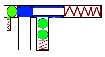

That could work well, reminded me of a design I had thought up before I knew how "strafer" BBMGs worked, it looked something like this with air and BBs feeding through the same port:
