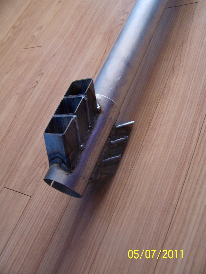

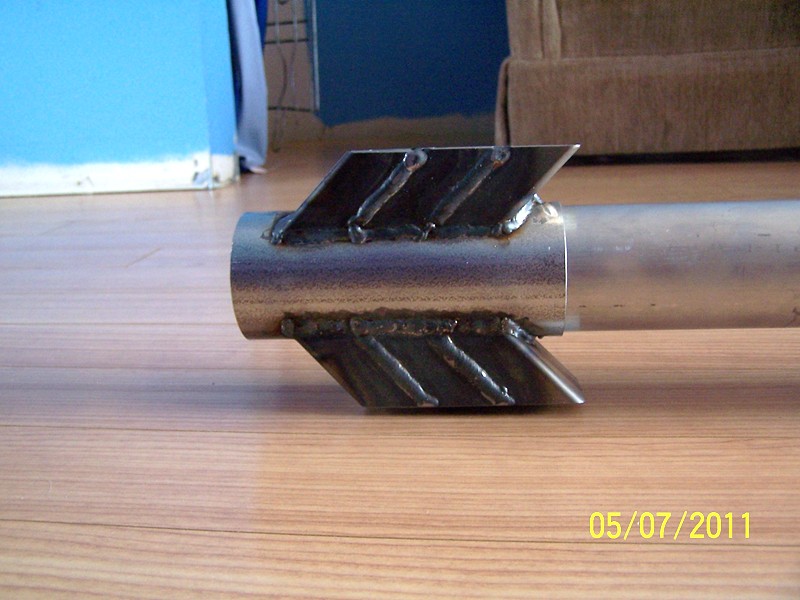

Here is my brake so far. It is not installed yet (I have to vent the longer barrel I have at the shop first). But, you get the idea.
I have two hours in it so far.
I actually do not like the look of it as it sits. I think it will have to grow on me. Besides, I still have to disassemble the cannon and powder coat and anodize everything. But, I have other modifications to do first.

Are the holes in the barrel the same size as the rectangles?

Sort of. The round tube the discharge ports are welded to has the profile of the ports cut into it. The barrel will be slotted so there will be two separate long slots running the length of each set of rectangle discharge slots. That way the slug will be supported at 4 points around the perimeter so it cannot wobble in the barrel.
Oh, the reason for 3 sets of ports is purely due to the length of my slugs. I wanted to make sure the slug was still well into the barrel when the brake windows became exposed.
The thing is, I do not want to just add crap to this cannon unless it will actually make a difference. It is not for adding accessories to. This cannon is for performance. Luckily, I have a second barrel (6 inches longer to accomodate the brake) that I am modding for this project. That way I can go back to my original barrel if this brake is ineffective. Heck, I only have $25 and two hours in it so far. No big deal..........

The muzzle brake will probably be somewhat functional as it is now, but recoil reduction will probably be minimal (because most of the momentum comes from the slug's velocity). Most likely it will just dampen the muzzle blast downrange, but directing the expansion uprange.

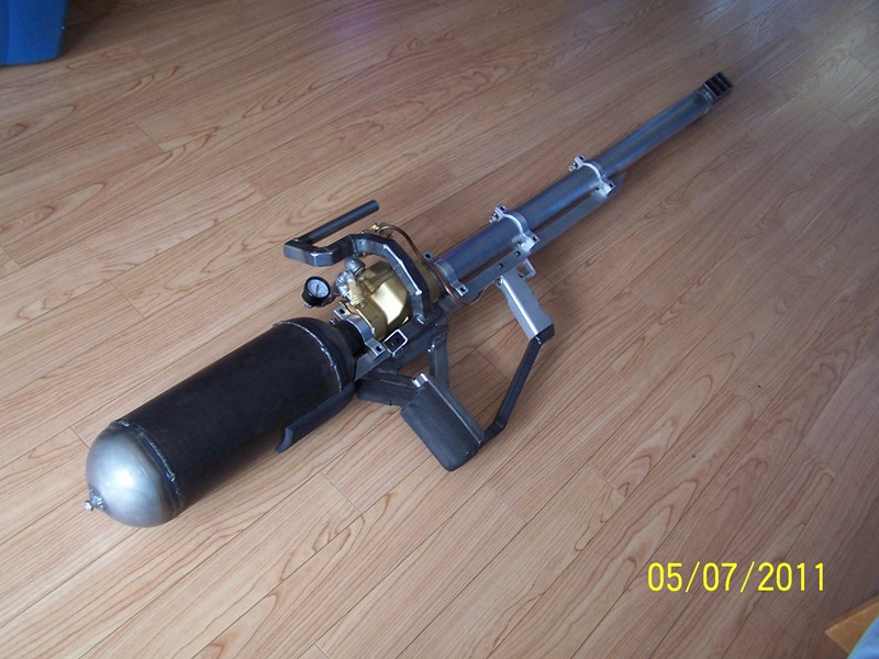

My tank is 2 gallons. The tank to barrel ratio is 3 to 1. I run 230 psi on most shots.
The look is growing on me. Oh, also, I need to use my flap-disc to smooth the welds as much as possible. I will, also, use my Dremel to bevel all edges and smooth the inside of the ports as well.
The primary reason for this is, I want to move up to 300 psi and a 1 pound slug. Right now the cannon weighs exactly 40 pounds. Yet, even with that weight, the recoil is pretty strong.

High-PSI wrote:The primary reason for this is, I want to move up to 300 psi and a 1 pound slug. Right now the cannon weighs exactly 40 pounds. Yet, even with that weight, the recoil is pretty strong.
From the pic, I'm guessing that your barrel is 1 - 1-/12 bore. IMO, I think a 1lb projectile with the medium bore size and only 300psi will be a huge disappointment to you as you don't have nearly enough horsepower to push it. The recoil will no doubt increase but, it will be from the excessive weight of the projectile.....not the gas exiting the muzzle. Muzzle brakes are very effective for the purpose of countering secondary recoil caused by the propellant gas exiting the muzzle ....not primary recoil caused by the projectile.

Actually, it is a 2 inch barrel. It may look smaller because the gun is so freakin huge. But, it is a 2 inch barrel and the bun is nearly 7 feet long at this point.
It fires through multiple layers of 3/4 inch plywood at 150psi. At 230 psi it slams me back pretty hard. I have a youtube link in my 2 inch cannon thread you can watch to see the recoil of the cannon as it sits.
Oh, also, the earlier comment about my valve is correct to a point. Yes, I realize a piton valve is higher flow. However, this valve will tolerate 800 psi per the manufacturer. It is not limited by pressure, but flow. Yet, with a 4 foot barrel, flow is fine. The CV is 53.
As I mentioned, the recoil is intense at 230 psi firing a 183 gram compound round. What I really want to do is move up to 300 psi (my compressor is good for 300+ psi) and a one pound slug. That is the reason for the muzzle brake.
