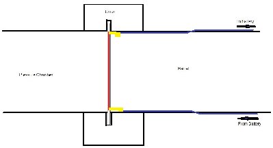

Here is my idea for the triggered burst disk. The Nichrome wire will be held to the mylar disk with duct tape, and the wire will be connected to the rest of the circuit using quick disconnects. The disconnects give a more rigid structure for easier connection.

About that picture: Leads inside the barrel? I'd be concerned they'd be torn off during a shot...
I will primarily firing those finned nerf howler footballs, as per my area's AT weapon regulations. The leads will only go an inch or two before passing through the barrel walls, and the rocket fins are about five inches long. The leads will also be secured to the inside of the barrel using some type of adhesive, maybe some of that liquid nails stuff.
