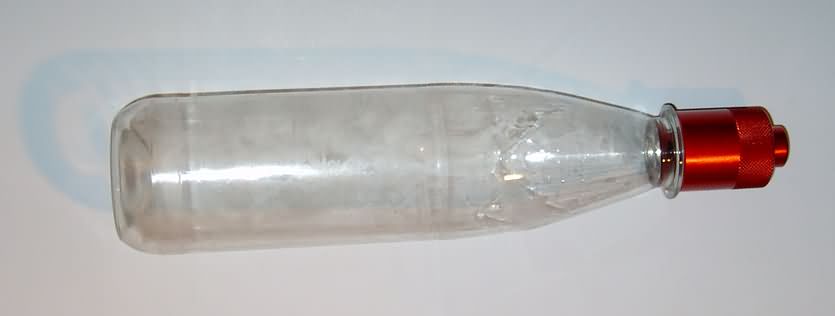

Ah, soda bottles. I can't help you fix the flow problems, but I can point out that adapters have been made, though good luck trying to find them now.
The adapters were soda bottle thread on one side, 3/4" female NPT on the other, with a small hole in the side, with 1/4" female NPT threads for a fill valve, guage, or pop-off valve.
<a href="http://thumbs.villagephotos.com/18682253.jpg">Small</a>
<a href="http://thumbs.villagephotos.com/18682261.jpg">Small</a>
<a href="http://img.villagephotos.com/p/2003-9/3 ... .JPG">Soda bottle dart gun</a>
I believe these were injection molded polyurethane, just like the custom valve tops that were made (also seen in that picture). I have a couple valve tops but I've never had one of the bottle adapters, so no first hand experience with them here.
