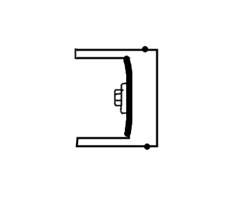

I'd recommend using a piston with the sealing face recessed back inside to save on weight. This is better to use on a barrel sealing design. You'll have to increase the travel a bit to ensure it doesn't block the barrel port with a chamber sealer.

- hollowpiston.gif (2.57 KiB) Viewed 4336 times

Edit: that is an interesting piston design but how would that work in a chamber sealing valve? i was planning on making a piston of the following design to save weight and it is near opposite of what you propose:
l----lllllll
l----lllllll
