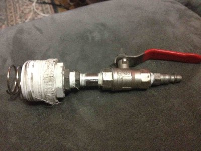

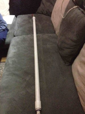

Specs.
Barel: .5" sch 40 pvc
Chamber: 1.25" sch 40 pvc
Piston: Epoxy cast w/ Rubber seal
Pilot: .5" Ball Valve
Length" About 6'

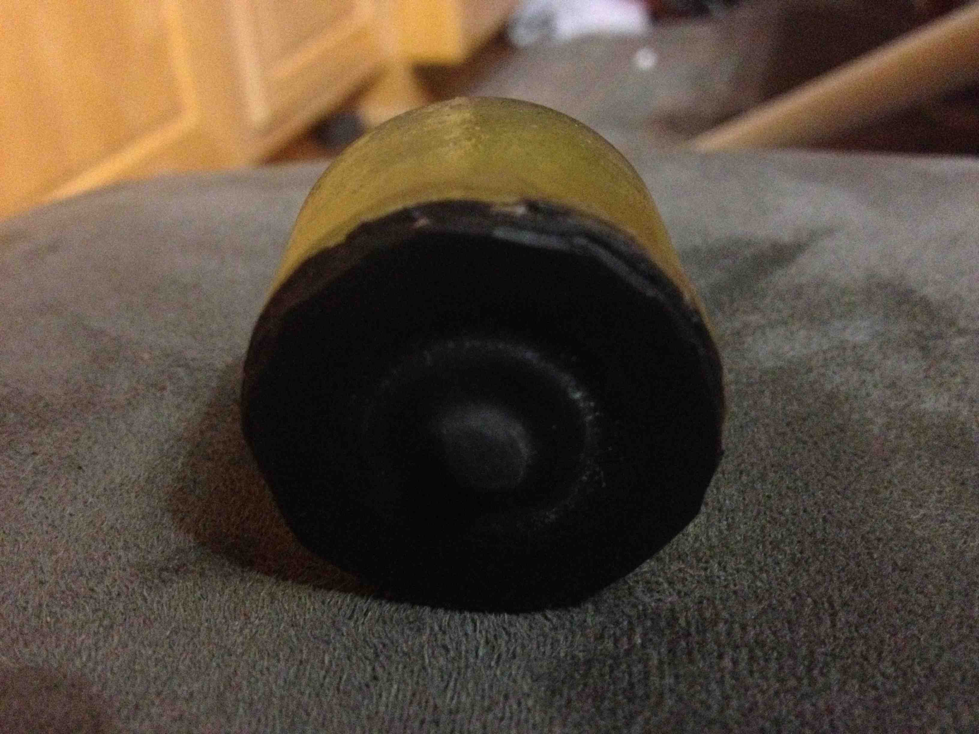

The Piston
The Piston

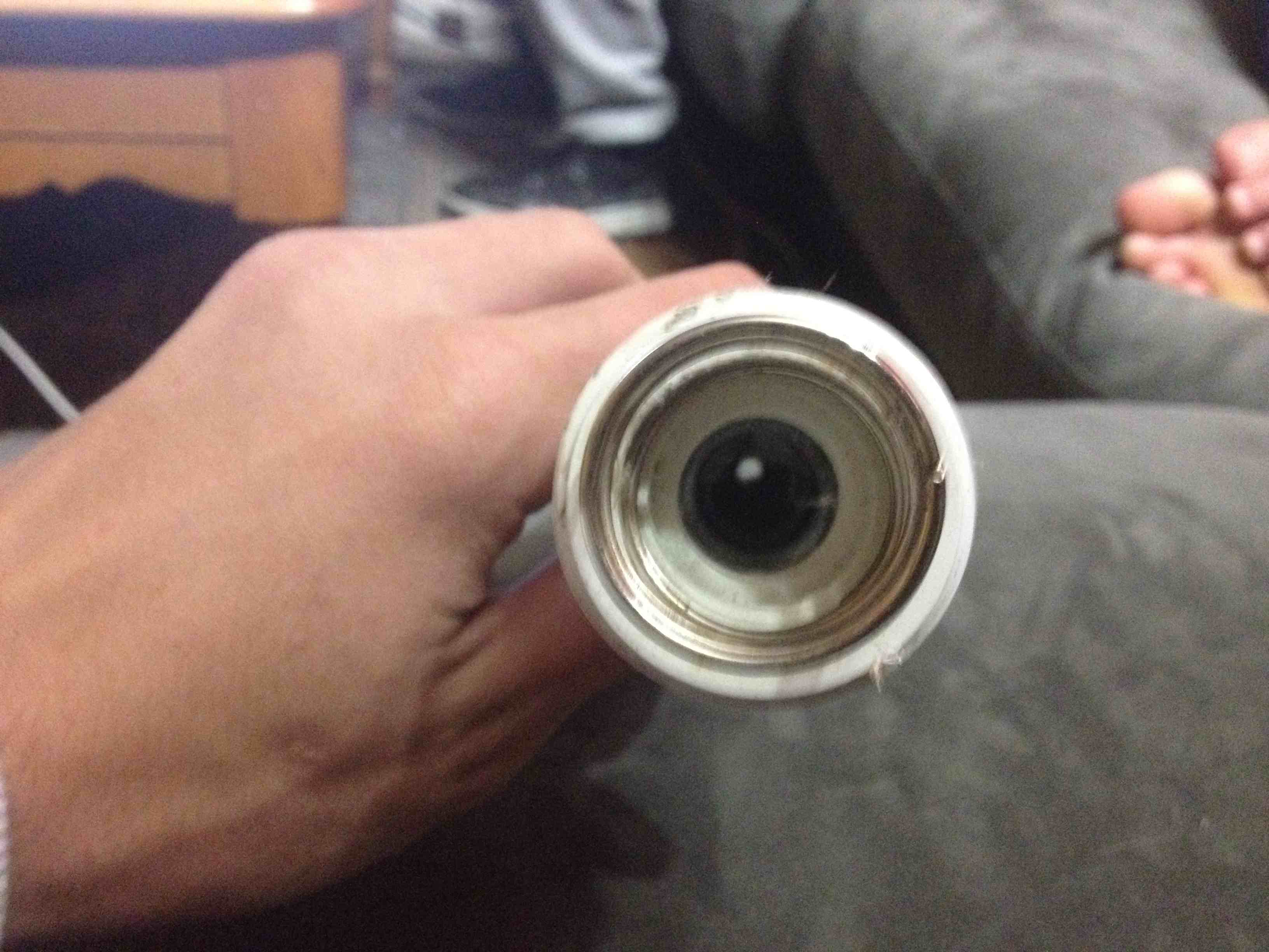

Ball Valve
Ball Valve

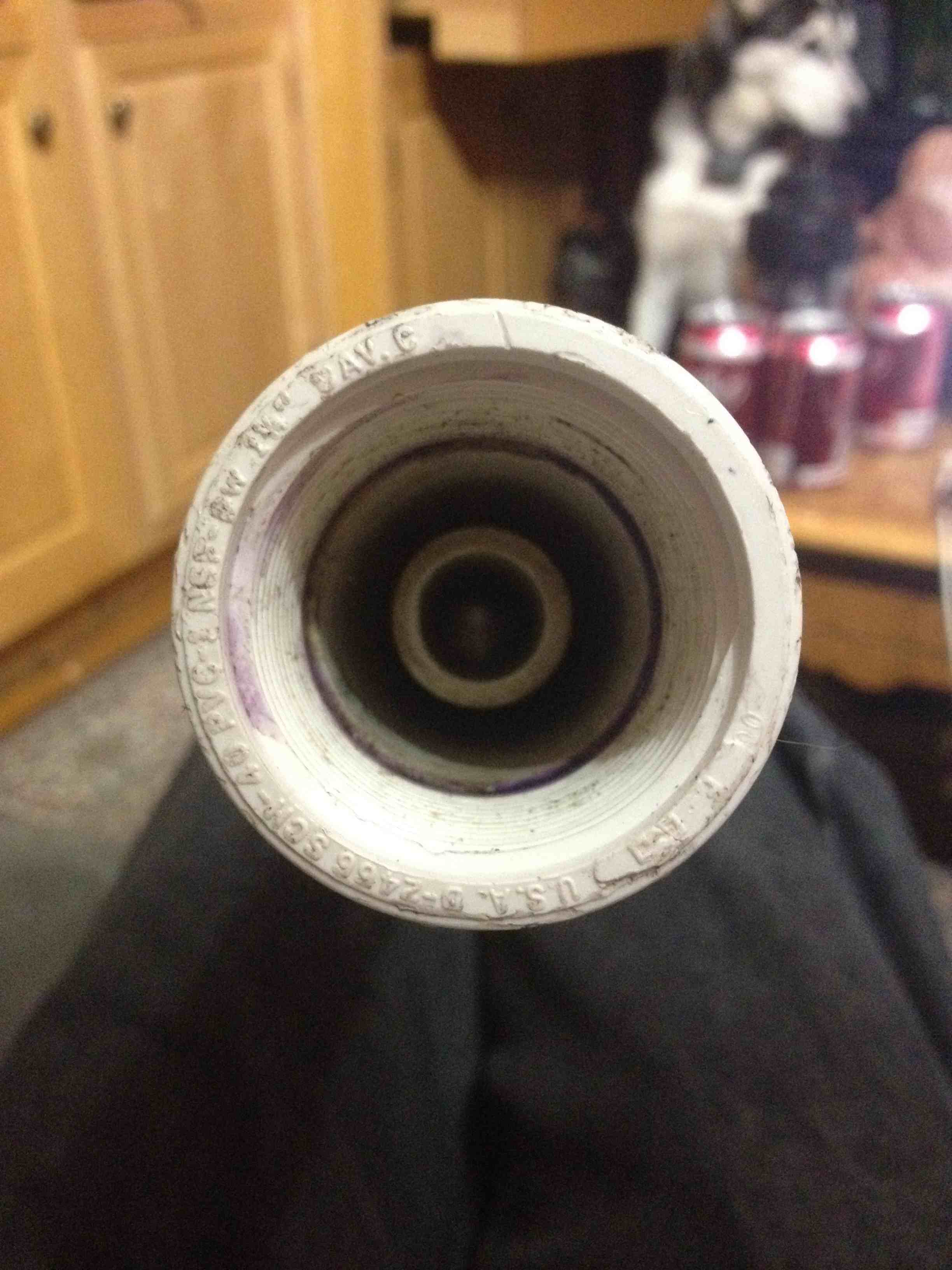

Rear Plug
Rear Plug

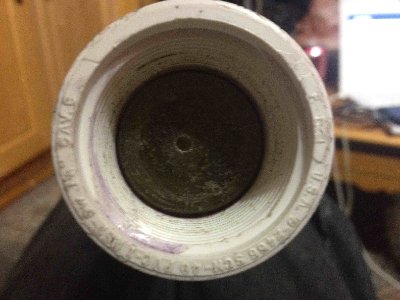

No Piston
No Piston
The Pilot with the piston
In One Pice
In One Pice

+10 newbie points for a well executed epoxy piston, nicely done :)
Is the barrel provided with some sort of support to keep in centred in the chamber?

Thank you i tried a bunch of different pistons but this is the last one, its lasted about 2 years so far
I had more pix but most wouldn't compress, yes there are 3 screws holding the barrel centered.

Nice work, clean, simple, and the lack of primer stains is excellent, even I'm not that good.
If I were you I'd use a 3/4" barrel, but that's not a concern. And I'm glad to see people lurking before they join, it's refreshing. Just be careful when you post, don't kick old topics, and you'll do well.

the first and second piston cannons i made had 3/4" barrels. Im not sure why i went with 1/2" this time it fits marbles and nerf darts fine but their is a noticeable power difference between the two. and fyi i don't know if you know this but 3/4" sch40 pvc fits rolls of pennies perfectly, great for putting holes in things

Well done. When you think you have enough bumper, add more. The Mouse Musket broke 3 pistons.

For some reason bumpers have never been a problem for me. This piston has been taking 130 psi shots for about a year and a half now. Plus the piston has very little movement < 1/4". The spring is more or less to keep the piston seated.
