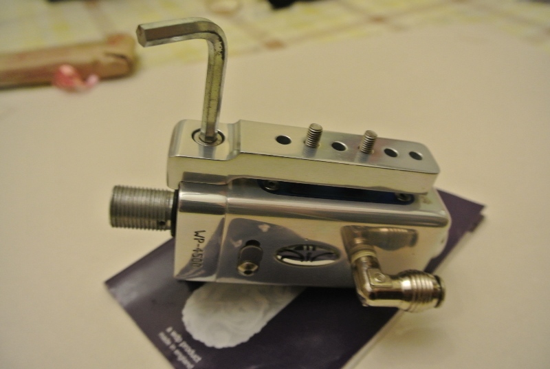

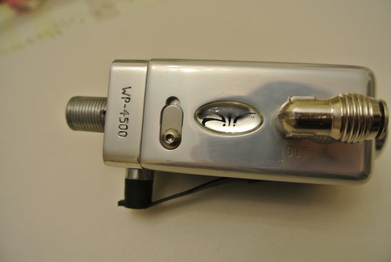

Well, I bought this, cost me 42 euros and something.

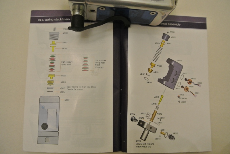

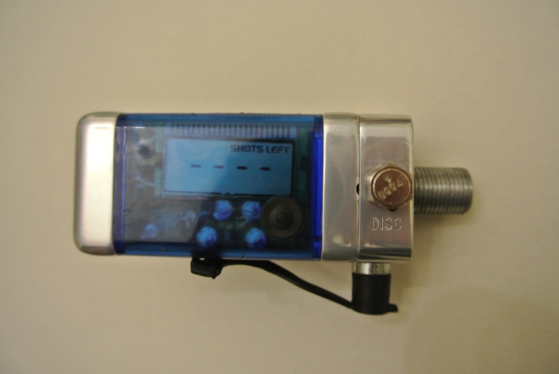

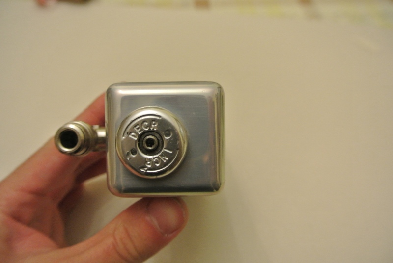

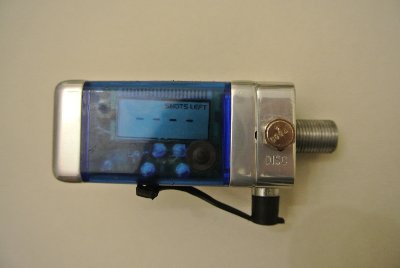

Totally worth it! Awsome regulator, the LCD shows both in-tank pressure and output pressure and using pressure drop per shot to calculate how many shots you have left. Besides, it allows external output pressure regulating and has two configurations (one allows adjustment between 100-500 psi, another for above 500 psi). It also comes with a very, very detailed manual, with all the information you need to operate/fix the regulator and a aluminium arm for mounting.
The only bad thing it´s it doesn´t have the pin valve that normal paintball regulator has so you can only fill the tank with the output of the regulator already attached to your gun´s valve.
With this regulator, I´m starting a new project. As I started play pro airsoft skirmish (with experienced players and their high-end AEGs/GBBs), I found out a sniper normally still owns most of the "kill"s. Currently I´m using a upgraded AEG, but the sniper from my team doesn´t do much so I started looking for a sniper rifle. Didn´t found anything good, when people are paying big money and physical strength (ever tried to pull the bolt of a sniper rifle with a M170 spring for a entire afternoon? :lol: ) just to get 500 FPS, while this gives me 560 FPS easily. But this time I what the main chamber to be incorporated on the gun, so I had to reduce the size of both chamber(main and secondary). In order to keep the FPS and economize the air consumption per shot, I bought a tight-bore airsoft barrel and metal M4 hop-up(so I can use a M4 magazine, same as my AEG), also will be using a hammer valve to eliminate the wasted exhaust air.
This project is now consuming most of my incomes and free time. But I´m going to take time and do this right :) also I´m open to the valve/trigger/reloading mechanism suggestions, still pondering for the most suitable combination.
The brand, WDP A.I.R
The LCD display, showing how many shots have left, nothing there because there is no air pressure to do the calculation
The screw to increase/decrease output pressure
The manual (a lot of pages and information)
The alumium arm for mounting

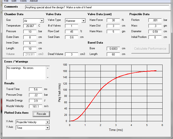

I assume you'll be using the regulator to have a "low" pressure firing chamber, this will remove the pressure curve. Ran some quick numbers into GGDT, with say a half inch ID firing chamber 2 inches long, and a 24 inch barrel, you could get a 0.25 gram BB to 500 fps with just 130 psi, a paintball tank will last forever!

Nothing happened to one shot, one kill, but Portugal it's a windy country, you never know if you will hit the target or not with a 0.25 g bb beyond 60 meters. 500 maybe too much, but it's a safe number. I can easily done 100 shots with a m140 spring rifle during practice, this build will be a lot easier to reload so I expect I'd be more trigger-happy so around 200, basically the bbs inside 2 hi-cap m16 short magazine. I'm doing some GGDT for 0.40g bbs, they seem to be a lot more stable.

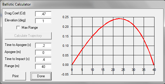

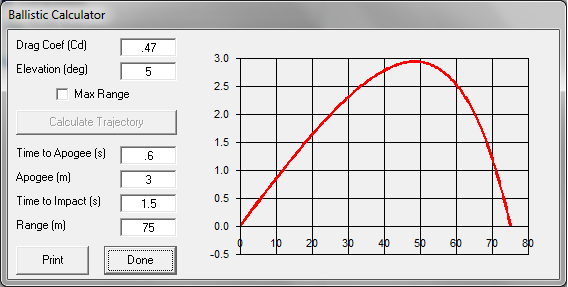

Found a suitable GGDT design, gonna follow it.
At 5 degree I got a nice range.
Sem Título1.png (23.65 KiB) Viewed 4748 times
range at 1 degree elevation
Sem Título.png (22.56 KiB) Viewed 4748 times
Sem Título3.png (37.5 KiB) Viewed 4748 times
