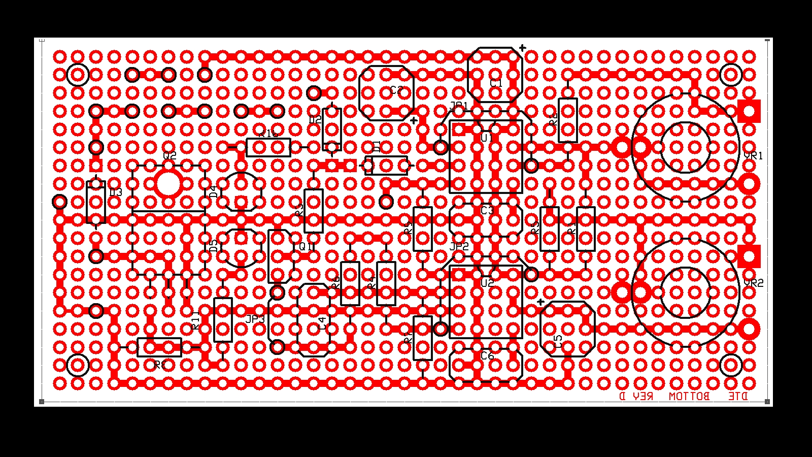

Zeus, I will post the schematic and board layout in this thread tomorrow.

Here is the schematic and board layout.
Note there is a component view and a bottom foil view.
I recommend the "safety switch" on the 24V supply because the 555's have a tendency to "pulse on" during power up.

And those diagrams make no sense to me
Safety is a big one, would like to have a working safety switch so the gun can't be accidentally discharged.
