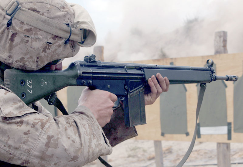

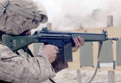

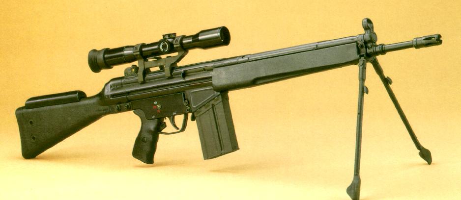

The blow forward bolt catridge ejector(where the mag will be) is away from the trigger ,in most of the assault rifle the magazine is close to the trigger eg: M4,M16A2,AK-47 and for rest it mostly bullpup configuration like Famas and Steyr AUG. In your drawings above, the AR-15's mag is close and your guns mag is away from the trigger.
If your main priority is aesthetics then I suggest you change the body from AR to HK-G3SG1 sniper rifle which has the the mag away from trigger maybe you can place the mag a bit further and not mess up the actual look of the gun.

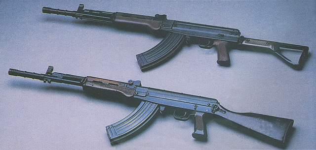

Also another assualt rifle which my country uses is Type 81 (below), has mag far from trigger ,
just some ideas to make the look more realistic.
