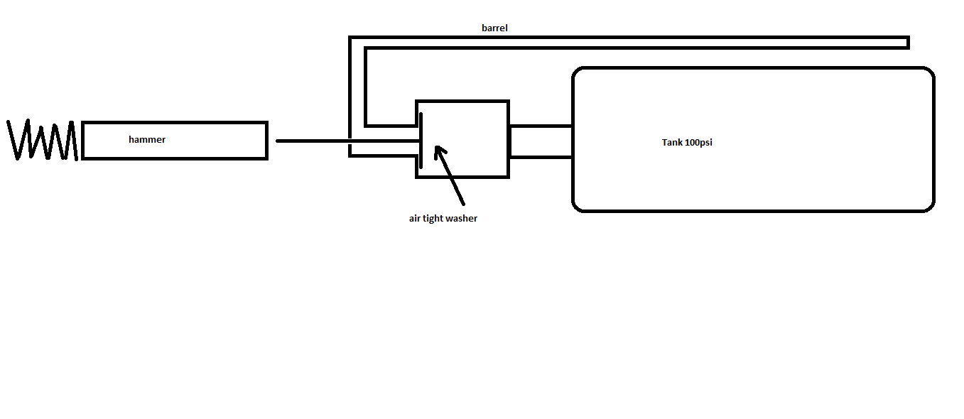

Here although I highly doubt you would be able to replicate such a design with very basic tools and equipment.
If you're really keen on the idea of using a regulator it doesn't actually cost that much to buy one for paintball, with really low end ones ranging in the £15-£20 range.
But, as bravootome said, a lot of PCP rifles using a hammer valve are self regulating, where you can adjust the output power by adjusting the hammer spring strength and doing a bit of fine tuning, so if you want a fairly compact multi shot PCP, I would go for a hammer valve based design, probably save you a few quid

Indeed it would, Wyz did a very good tutorial on converting a blowgun to a hammer valve a while back, have a look, saves on you having to design and try and fabricate your own, which can be quite a chore for someone who I'm guessing doesn't have access to their own lathe. and given they only cost around 3-7 quid, it doesn't really break the bank to experiment and play around with them.
Just, when you're making it, ensure you maximize flow on all your components for ball bearing firing.
personally I think using a chamber at pressures of around 250 - 300 psi would be a good idea (or more if you're really power hungry) with those kinds of pressures and a powerful hammer I've put 3mm ball bearings straight through soup cans, and that was with a really inefficient set-up, I'm sure you could do better with a good flow and larger bore
