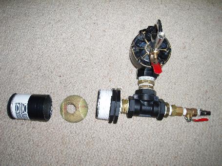

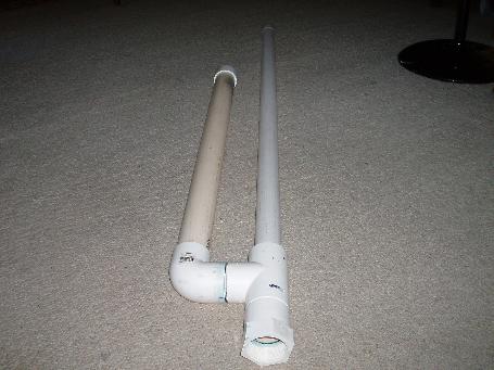

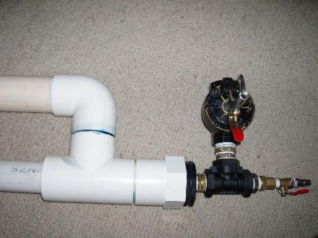

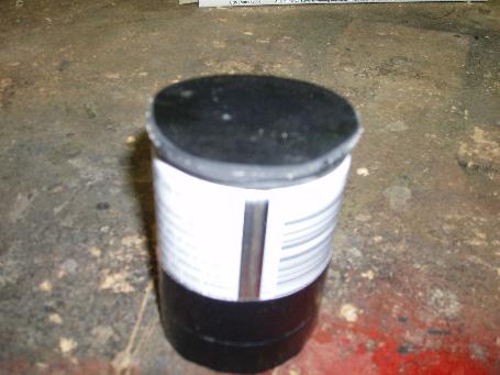

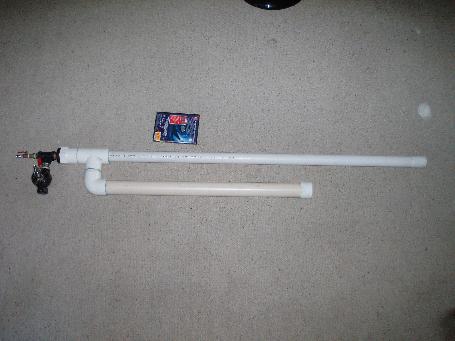

mehhh coudlnt be botherd with.Maybe some other time i might update..The barrel is 1.9 meters the chamber is 1 meter and the piston is madefrom a air fresher can with come bog and tape for sizing in the chamber its piloted with a sprinkler valve it shoots large marbles very well but i havent tested a golfball yet.
UPDATE:The chamber is made of 50mm class 18 and the barrel is 40mm class 18 i had to shave the inside of the 50x40 recuder to allow the 40mm barrel to pass through into the T.
The filling system is filled with a 1/4 ball valve and male disconect and my samuel MKII valve si the pilot i also have a extension pipe for the vavle but i preffer the blow gun mounted flush on the sprinkler valve.The piston is verylight and thus makes the opening time faster it weighs in at a whopping 50 grams!When this gun is fired its extremely loud and if fired in confined spaces causes slight hearing loss and ringing.The piston can be removed for servicing or replacement which is easy as it is made from a spray can.I plan to make a barrel suport for the chamebr and barrel when i get the chance.
So what do you think of my gun?Comment what you think!
This is the full gun with a DVD case as size reference
This is my piston,very light and very cheap.
Open valve.Were the magic happens!
Closed valve.Explaines itself.
The bumper,made from a half section of a tennis ball wiht the fur removed and a hole in the centre for venting.

A back view wiht out the piston and fireing system.
Close up of the whole unit.
