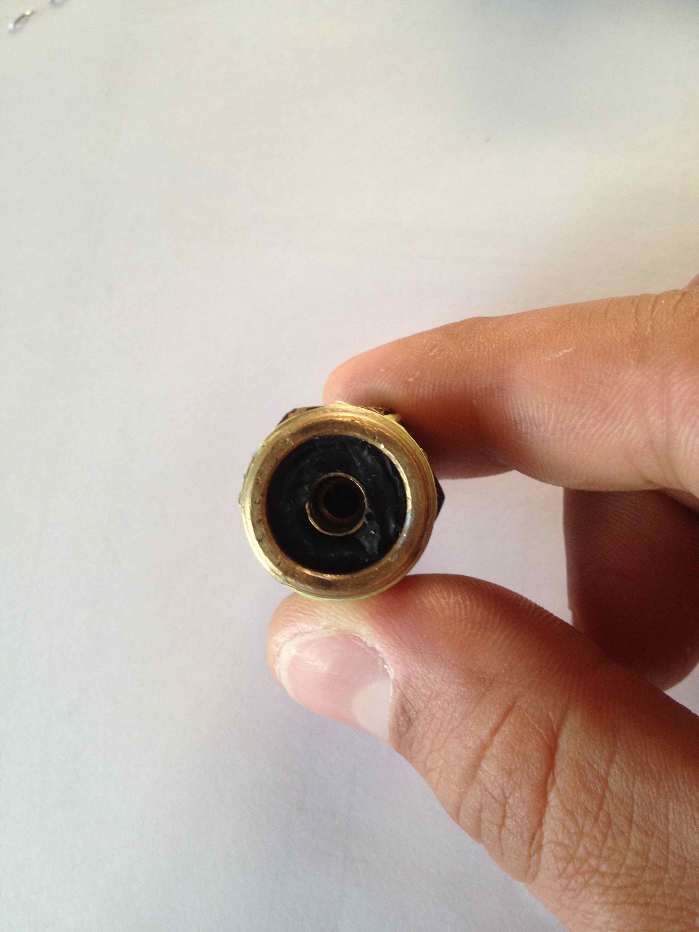

This demonstrates the hole I drilled through the end cap of the valve, I also expanded the in and out ports of the valve. That tube is 8mm like I showed in the diagram above.

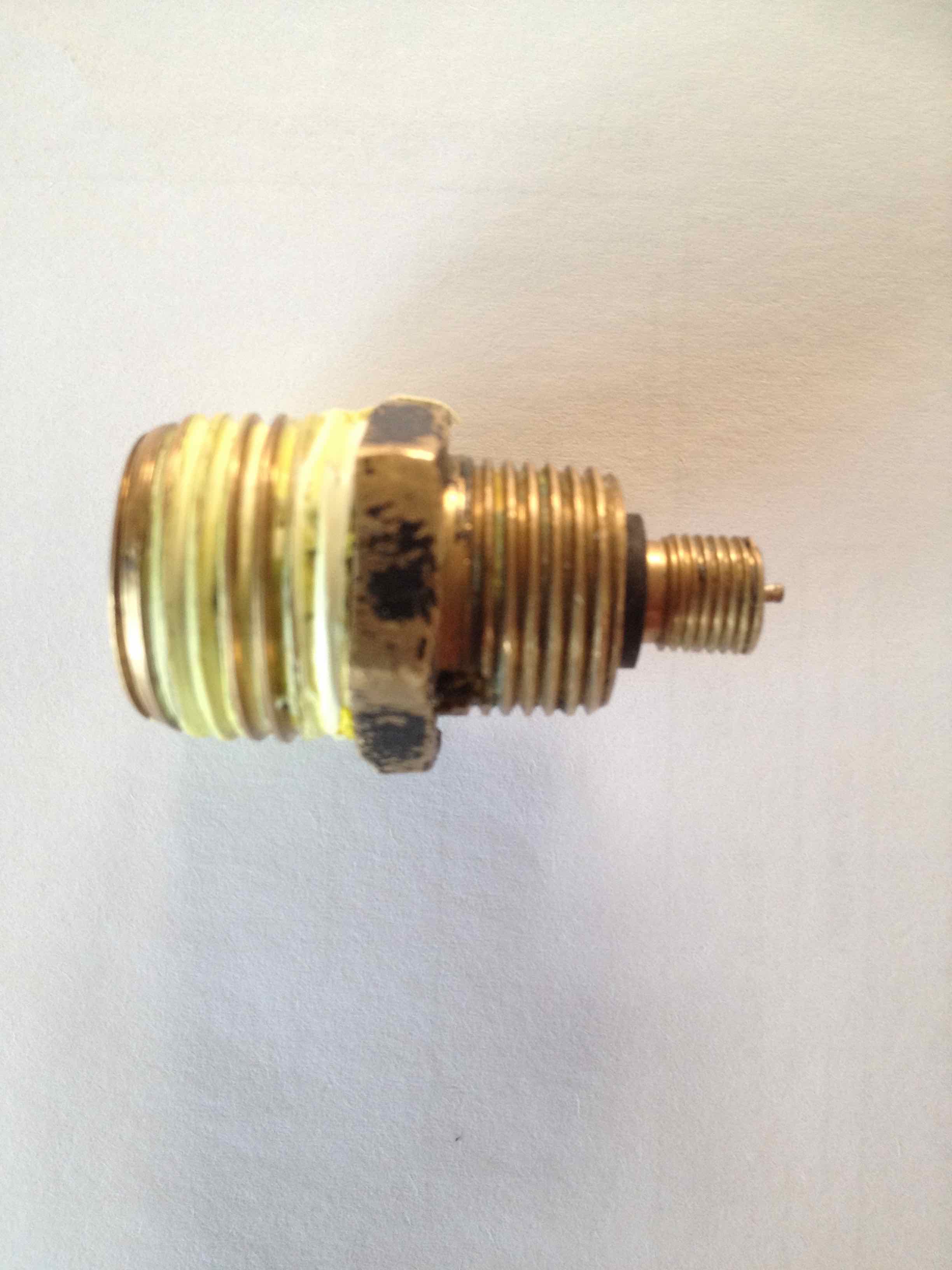

I have trimmed down the head of the schrader to allow some of the pin to be exposed for striking.
This is the fitting I use for schrader piloting, Notice that the body of the fitting is fully taken up by the rubber of the schrader, I also glue them in place with some crazy rubber metal glue that I have (it's from locktite, can't remember the number). This has the effect of reducing the pilot volume significantly but I also put in a bunch of plastic washers that compress against the body of the QEV and the schrader rubber to further reduce the volume to basically just the area of the piston times the travel distance between open and closed (about 0.2 - 0.5ml is what worked for me).
