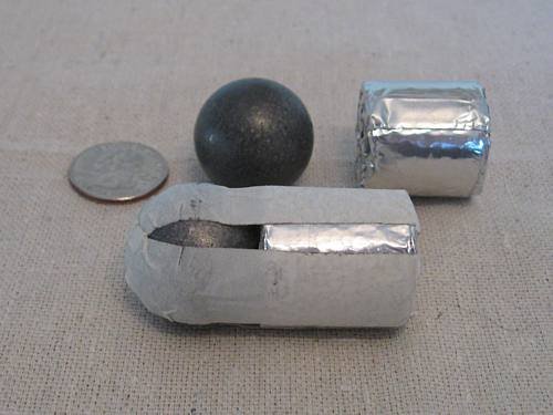

I fold a double layer of T-shirt material over the front of the golf balls. Works well with the 44mm internal diameter of my barrel. :lol:
[url=https://flic.kr/p/XdYNRW][img]http ... .jpg[/img]P1070480 by Terry Griffiths, on Flickr[/url]

That's pretty nice damage!
Could you share the design of your launcher?
