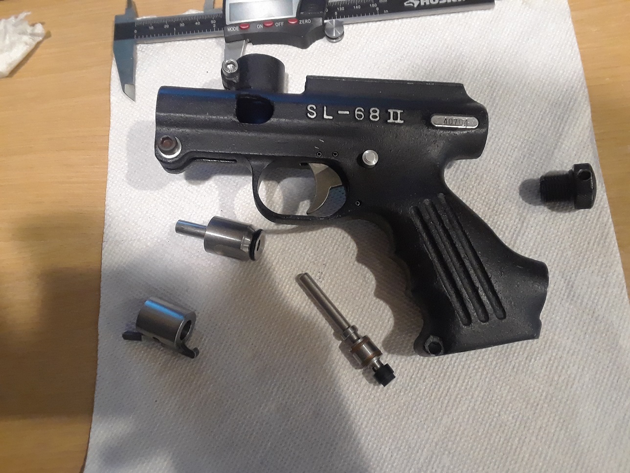

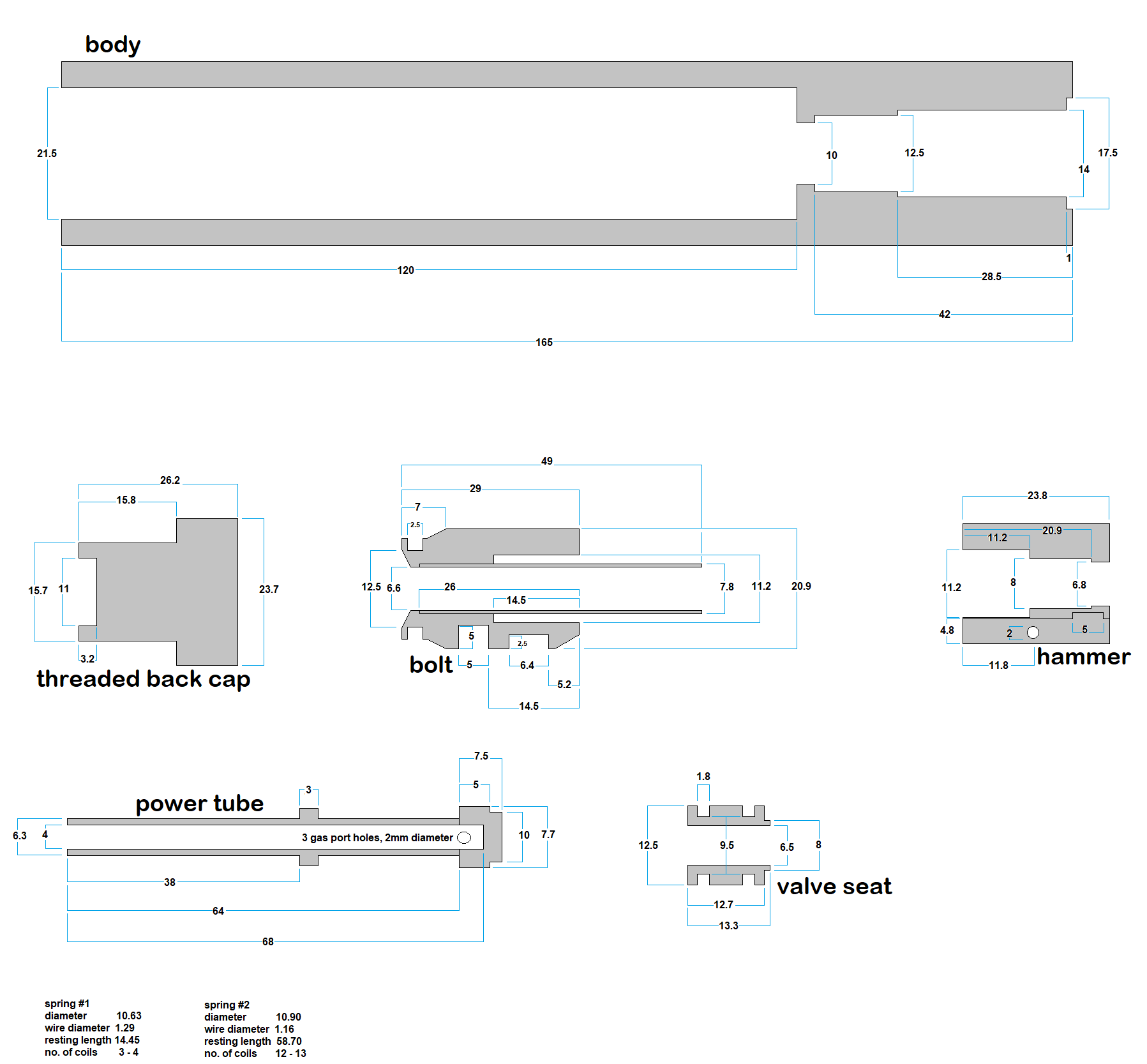

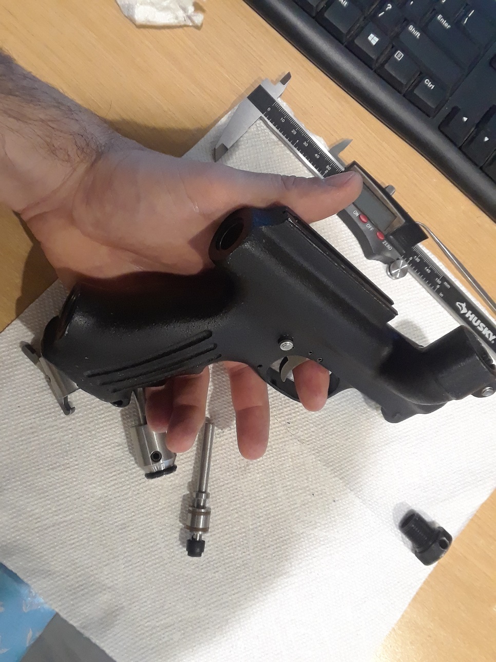

I have taken measurements of a Tippmann SL-68 II paintball gun internals, mostly for my own record keeping but others may want to take advantage of this data. I couldnt be bothered taking measurements of the bolt-catch or trigger - tough tacky, figure it out from the pictures. Adjustments may be required, but the measurements are pretty close.
All measurements are in millimeters. Based on the Nelson valve.
metric dimensions
metric dimensions

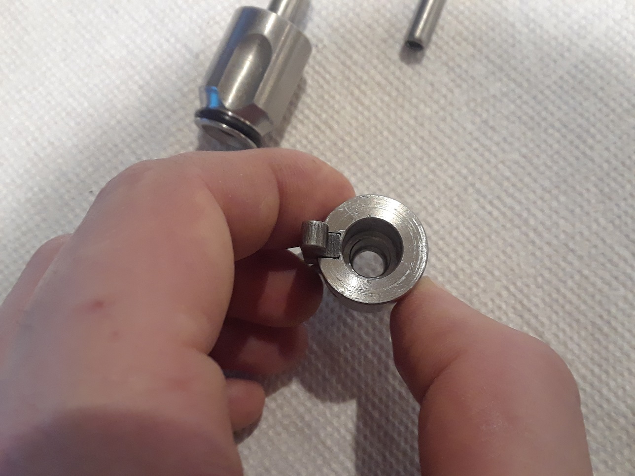

cutout in bolt to prevent paintball chops

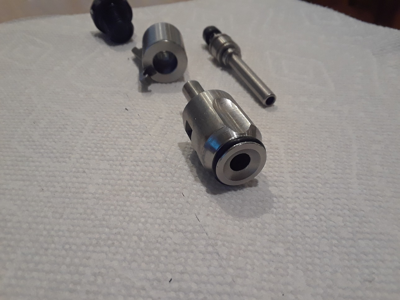

inside the bolt
inside the bolt
trying to show that the bolt is made of 2 pieces, very tightly fitted

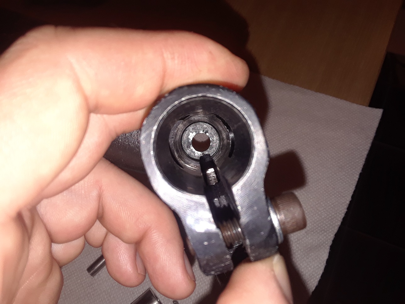

inside body
inside body
back side of body. valve housing area
overall view of body and components 1
overall view of body and components 2
overall view of body and components 3
overall view of body and components 4
overall view of body and components 5
view from back of body with valve installed
view from front of body with valve installed
