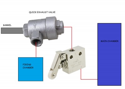

could you show me how to set one up in a basic semi-auto configuration

Oh that's what I was going to do but I thought it would be different since the valve is 3 way. Thanks a ton anyway

What is that 3 way valve with the lever called?
Sat Aug 17, 2019 10:01 am
Search for "3 way valve roller" on eBay and you will get loads of results.
