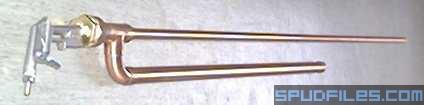

This is a gun I've always wanted to build, a pneumatic marble gun out of copper. It has a 2m long barrel of 18mm copper pipe, a perfect fit for 16mm (5/8&amp;amp;quot;) marbles. The chamber is made out of 1m 28mm copper pipe, with couplers the total chamber volume is about 580cc. All copper parts are sweated (soldered) together, with a 35mm brass coupling on the back end, to which the blowgun is connected. The back of the coupling can be screwed off to allow access to the valve. This picture was taken after the gun was polished and coated with several layers of metal varnish. I'm going to add barrel support, some sort of shoulder strap, possibly a tripod, and a CO2 setup. The gun hasn't been tested with marbles yet, but it has been dry-fired at up to 180 psi, at which it gives a loud crack. The air from a dry firing blasts great holes in newspaper.
This is a gun I've always wanted to build, a pneumatic marble gun out of copper. It has a 2m long barrel of 18mm copper pipe, a perfect fit for 16mm (5/8&amp;quot;) marbles. The chamber is made out of 1m 28mm copper pipe, with couplers the total chamber volume is about 580cc. All copper parts are sweated (soldered) together, with a 35mm brass coupling on the back end, to which the blowgun is connected. The back of the coupling can be screwed off to allow access to the valve. This picture was taken after the gun was polished and coated with several layers of metal varnish. I'm going to add barrel support, some sort of shoulder strap, possibly a tripod, and a CO2 setup. The gun hasn't been tested with marbles yet, but it has been dry-fired at up to 180 psi, at which it gives a loud crack. The air from a dry firing blasts great holes in newspaper.

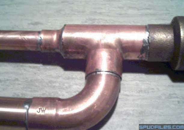

The bulk of the soldering was on the tee, where the chamber, barrel and connector all come together. It was a bit complicated to get everything lined up, since I had to heat and solder all the parts in sequence, to prevent the heating one joint from breaking another. The barrel came on slightly askew, but with some grinding on the end, it seals perfectly. The soldering on the brass connector wasn't airtight in the first try, probably because I hadn't heated the large brass fitting enough, but it was successful on a second try. A piece of 28mm pipe is used to connect the brass fitting to the tee, the piston slides inside this piece of pipe. You can see I've begun to polish the chamber.
Polished copper looks very nice.

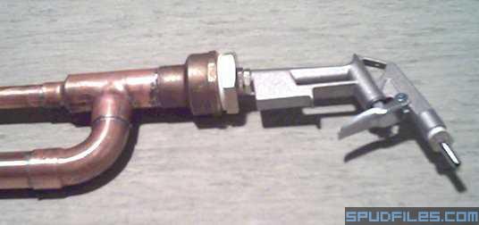

This is the assembled valve. the hose barb connected to the blowgun in the picture is a perfect fit for the air chuck on a 12V compressor. I also have a quick-disconnect fitting for connecting the gun to an ordinary compressor. <br /><br />The parts of the valve have been changed a bit since the pictures were taken, and I've definitely forgotten the cable to my camera in Norway, but I'll get some updated pictures of it as soon as possible. The concept drawing of the valve also needs to be updated accordingly.<br />UPDATES!<br /><br />There is a shopping cart stuck in the ice at the lake, which I used for target and support. first shot was through the wheel, which was no match at all.

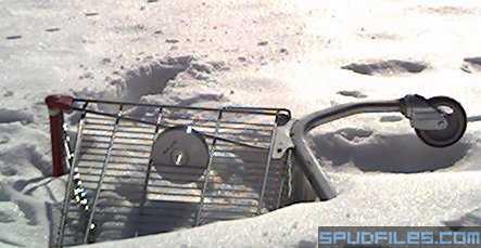

I did some range shots with a relatively flat trajectory, I think I can shoot across the lake at good elevation (400m) but there's popular a hiking trail all the way around it so I won't try. The lake is about a mile long so I can do range tests that way when there's no people on the ice, but I don't have any way to see where the marble lands. A smoke marker or something would be nice... <br />Another shot at the bars of the cart bent one of them out of shape.

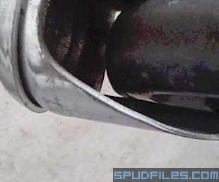

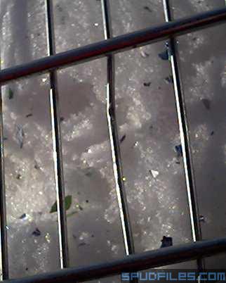

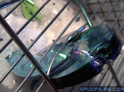

I had brought some junk CDs I decided to shoot
The first shot hit near the edge, and tore successively bigger holes in the CDs. The hole in the first CD was about the size of a marble, the last one was about five times as large.
A second shot through the middle split some of them in to, and broke a large hole in the middle of others.

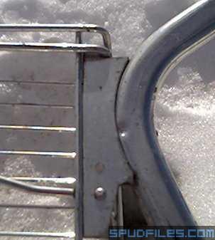

I also put a nice dent in the frame of the shopping cart with one marble.
I actually found one of the marbles, its shape suggests that it was the one I used to make the dent. A bit in the center of the round part was crushed from the initial contact, when the marble was stopped by the metal, the parts that wasn't braced against the inside of the dent came off and was probably pulverized against the metal in front.

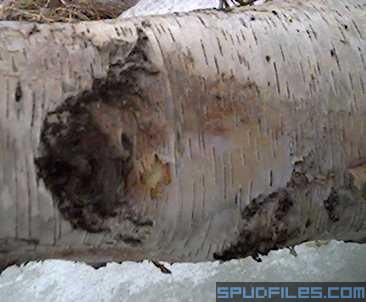

But it only took the bark off of a fresh tree.
The picture is accurate, this tree is actually horizontal at the point where I hit it. The damage will grow shut over the summer. If you shoot soft projectiles the shreds will explode outwards when the projectile hits the wood, and can tear large holes in the bark. <br /><br />Finally, what I was planning to do was to see how many tin cans I could shoot a marble through. I took the eight ones I had brought and stacked them together, and braced them against the shopping cart.

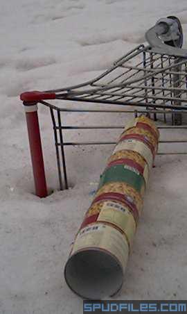

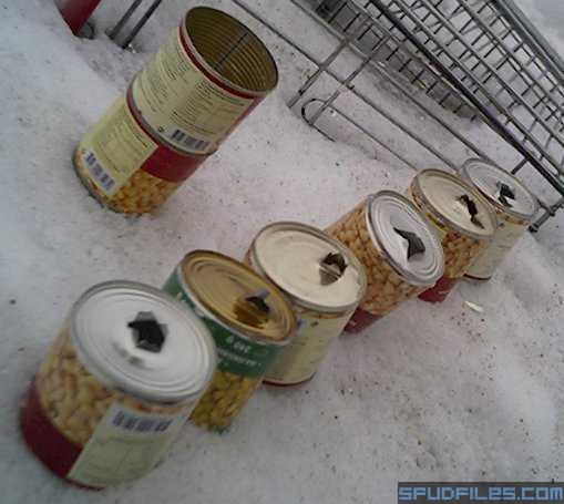

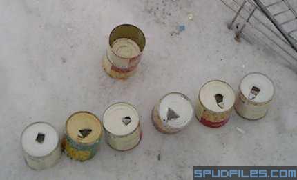

Then I loaded a marble, pumped the gun as high as I could, donned safety glasses then lined up the barrel and fired.<br /> <br />The marble went through the bottom of six cans before stopping with a big dent in the seventh. The seventh can was pounded into the eighth, they couldn't be separated by hand afterwards. The order in the picture isn't the order the cans were stacked in.
Top view
Top view
The marble was chipped on both sides.
It was given an honorary escort of two other marbles to some place out on the ice. The cans went in the metal bin at the recycling station. <br /><br />Shot some more today, since it was very nice weather unlike last weekend. I improved the seal on the bike pump, so I could get the gun up to about 110 psi this time. I'm probably going to buy a big-ass CO2 tank and regulator, unless it's too expensive or cumbersome. <br /><br />First, I decided to take it out on an old sandal

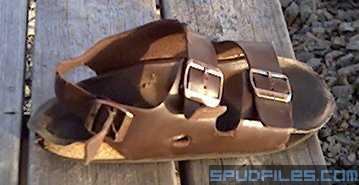

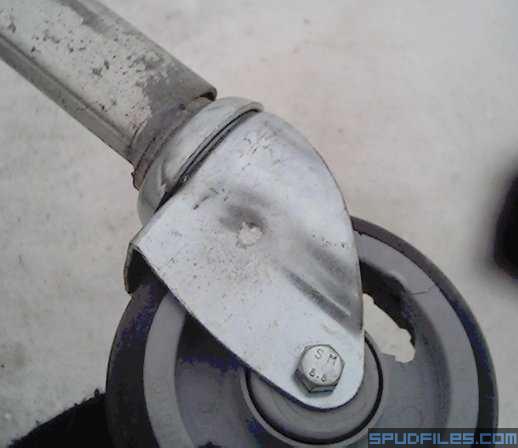

The marble went straight through, and had enough energy left to put a nice dent in one of the bars on the shopping cart

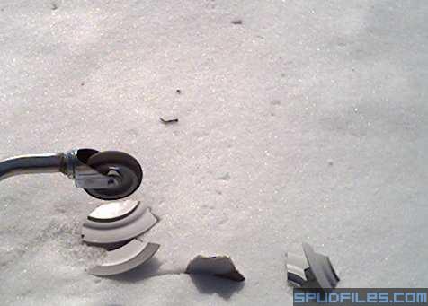

Then I set up an old dinner plate, that had decided to break for no apparent reason. The glue job wasn't satisfactory, so I decided to do the best out of the situation
This result was more satisfactory.

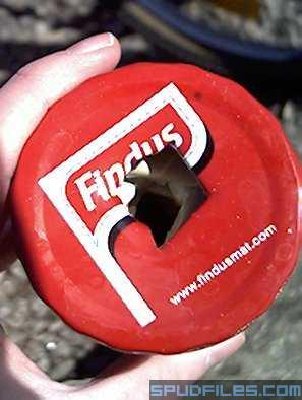

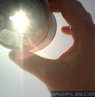

With my newfound increase in pressure, I had to do another penetration test. I didn't have enough tin cans, but I had a lot of jar lids that were about as thick. I filled two tin cans with lids and fired a shot, which made a nice hole.
The marble went through six lids and was stuck halfway through the seventh. The eighth lid, the last one in the first can, had a hole in it, and the bottom of the can was dented.
I then reassembled the stack of lids, and shot four marbles simultaneously into the cans. Two of the marbles were completely pulverized.
And the hole through the first can of lids was completed.

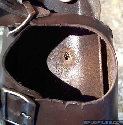

I went out and did a few more tests, because I wondered if I could shoot through the leather on the top of sandal. That was no problem.
The leather isn't particularly thick or strong, I do have some old leather shoes, but they're still far too nice to be used as targets. They're my spudding shoes, which I use when I don't want to mess up my nice pair. <br /><br />I also shot the top of the failed fan-in-a-bottle, the plastic kind of peeled off, and closed the hole after the marble had passed through. The exit hole (right) was much bigger that the entry.
