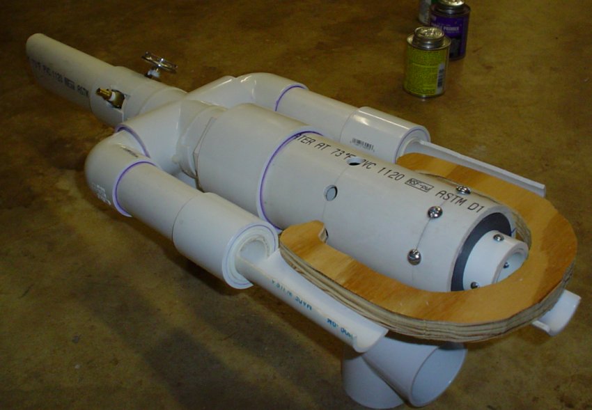

To avoid having to have a huge barrel and awkward sabot, I had a reusable piston device on my horseshoe launcher. As you can see, there is a large amount of barrel dedicated to stopping the piston (everything after the holes)

One of the ones I used did trap the piston:jackssmirkingrevenge wrote:Actually, it's not the same idea, there are no floating pistons here - essentially the idea being proposed is simply a sabot that doesn't actually leave the barrel.Hotwired wrote:I tried this stuff not long ago under the exact same name: http://www.uksgc.co.uk/forums/index.php?showtopic=932
The trapped air slowly seeped out around the piston but on one occasion the barrel was blown off the cannon and impaled itself in the ground.

What you created there is essentially similar to a spring piston air rifle - it would have been interesting to compare performance if the projectile was attached directly to the piston, eliminating the smaller barrel, or indeed to just have the smaller barrel using the same pressure and a conventional valve.
