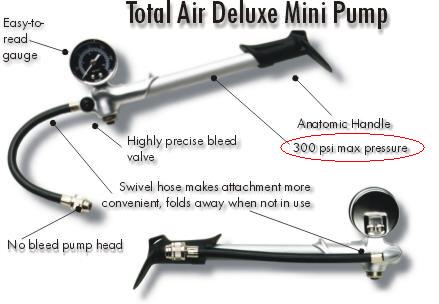

Mon Apr 23, 2007 11:01 pm
already is man. i bet i can get this pump to 350 after the footy season is over (AFL that is)
you need one of these:
Image and a girlfriend*
*because once you're done pumping to 400psi, there's no way you'll have enough energy left for any self-indulgence you might have been planning :D

i am in the stages of hacking a blowgun around to fit in a custom grip kindof like the copperhead prime gun by hotwired. until then though this will have to do.
meh mini pump, the fact that it says 300psi max not 300psi rated turns me off it a little im also making a 16mm bore pump from the plans that b the b
posted.

Mon Apr 23, 2007 11:25 pm
I have the exact same model and I've been taking it to 400 psi+ (well off the gauge...) for years now, the only maintenance I've ever had to do is a few cents worth of O-rings on the piston.
Re: the g/f comment, I meant you'll need one because after using the pump you won't have any strength left in your arms :P

oh nice but i have seen a better shock pump in a store close to me rated 450psi so when i get the cash i might get it, or a reg and bottle.

So chaos, for what prices have you seen decent pumps that are 300+psi rated? I came across a similiar one to what jack put up, for like $60 ($Aus of course!), with a gauge that went to 300psi, unsure if it was rated to that or not.

the one i saw was a motorbike shock pump it was about $180 AUD rated for about 450psi
