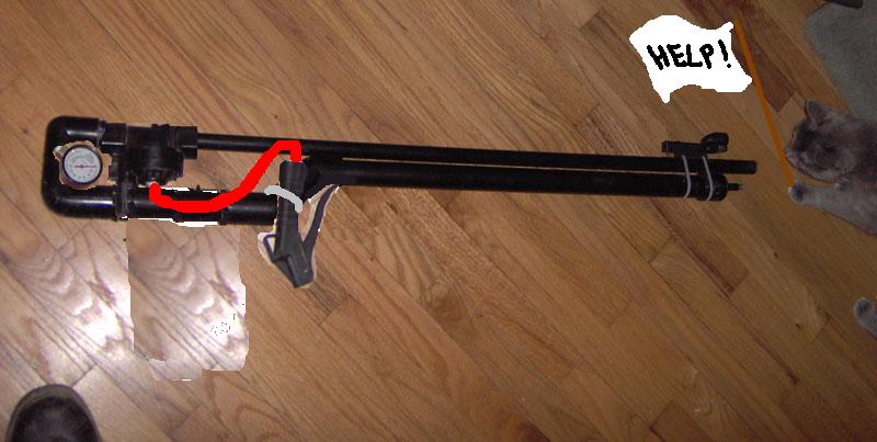

I made kind of a test pneumatic just to make sure the modded sprinkler valve worked. Just seemed to easy to be so effective. Anyway, after I made that one I started on this one. I've got no imagination at all, so there is a good chance I copied this design from someone without realizing it. If it was you, let me know and I'll credit you.
It's got a 32" chamber of 1", a 36" barrel of .5", and a 1" modded sprinkler valve.
I need to find a way to rigid mount the red dot scope once I make sure it's close. I'm thinking some good ole JB Weld unless someone has a better suggestion. And before you say it, I know the schrader isn't in the best place. I'm having trouble finding the threaded type. Everyone seems to be out of them here. And I'm leaving the solenoid on in case I need to remote fire it for some reason.
But running it right around 100psi and using some wadded marbles, and bits of 5/8" dowel. Fired it off a little last night but it was too late to really see a whole lot, but I was impressed with the speed of the marbles. GGDT says it should be firing right around 500ft/s. Hope to get out during the day for some damage pics and to get that sight dialed in.

edit: should have known better....its all PVC and all pressure rated parts....just painted
