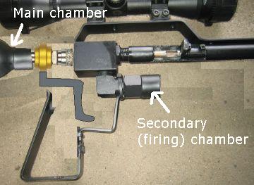

Here's a (very!) rough concept drawing, the bottle becomes the stock attached to the slide valve and the firing chamber is made much smaller.
JSR I've drawn on your picture, is this right? What effect does the trigger have? Does it fill the firing chamber? If so how does it pilot? I'm assuming I still use the qev as is?
- semiautoconcept_200.jpg (20.87 KiB) Viewed 5641 times
Yes.cane toad wrote:JSR I've drawn on your picture, is this right?
The yellow bit on the slide valve is the part which slides. The slide, as it were
In the forward position (trigger at rest), it connects the pilot area of the QEV to the main chamber. This fills the pilot area and the firing chamber.
In the rear position (trigger pulled), it shuts off the air supply from the main chamber, and opens the pilot area to the atmosphere. This pilots the valve, emptying the firing chamber.
Release the trigger (you have to add a spring somewhere) and the slide goes back to the rest position, filling the firing chamber and allowing the cycle to be repeated.
YesI'm assuming I still use the qev as is?
If the thread matches your QEV, you should be fine.
Here's an example of a QEV/slide valve launcher: http://www.spudfiles.com/forums/semi-au ... 22363.html

On your last one, the chamber volume had to be bigger to compensate for the low flow, slow valve. Now you have a high flow high speed valve that can use a smaller chamber more efficiently. Also, the really gain in power from shrinking the chamber comes from being able to pump it to higher pressures, twice the pressure generally results in four times the velocity*cane toad wrote: Lockednloaded - Thank you. Yes it has more power than the last one. You make an interesting point, I know the chamber is way too big (not a deal breaker for me since it was a scrap part ie free and I'm filling with a compressor) however when I tried a smaller chamber (using a length of hydraulic hose like my last gun) I seemed to lose a lot of power. I haven't done any further testing in that regard, ie what the optimal chamber size would be.
