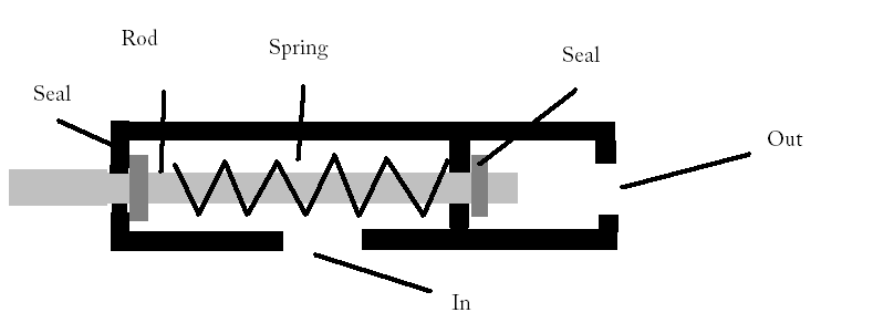

I looked at the valve again, in order to fire, one has to press DOWN on it, meaning its at a 90 degree angle, what I need is a 180 degree valve, where I push it left and it fires right, or I push it right and it fires left. This only works if I push it down, and it'll fire left/right
http://www.clippard.com/store/byo_contr ... valves.asp
Can someone help me BUILD one? 'Cause I have no idea how I'm supposed to do it. Basically, its a straight (180 degrees) valve with a spring return and a stem. When its left as is, pressure is vented via exhaust. When spring is pressed down, air. Ex:Spring on left, exhaust on the right. When spring is left as is, air is vented out of a hole to the atmosphere, when spring is pressed, the air is vented out to the exhaust on the right. I noticed how you can't link the builds, so just tel me the build please, you have my thanks

I don't think I understand what you mean. Tech's QDV works just like you described... or the design I posted on the previous page

The design you posted only moves the back part, I rather it moves the back part of the cylinder. And as for the valve MJVO-3, I think I mis-interpreted it, just as a run down. air source though threaded part( top of the pic) the metal thing sticking out is the spring and and other 1/8 NPT port is for the the barrel? What's the little exhaust hole for?
At least, thats how I want it, on a second look, the threaded part is the out, which means if the spring is pushed, air flows from chamber to barrel straight forward, I want the flow to be at a 90 degree angle

The Clippard valve is a 3 way valve... your diagram is saying you only need a 2 way. I think the MJV-2 is the valve you need.

What's the difference again?Also, same problem here, look at my diagram again, the in and out are reversed

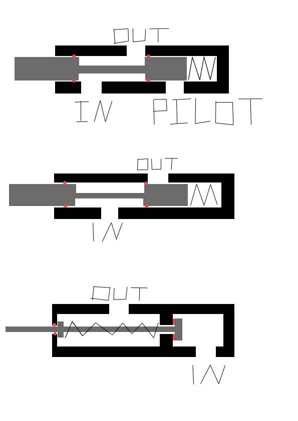

if you were using a 3-way valve then it would be to fill then pilot a piston valve, but if you are use the valve as the main valve then you would only need the 2-way, a 3-way to fill then pilot a piston valve would be much better performance than using a 2-way because opening time would be much less and flow would be much better

I'm gonna seem like a kid..but..IN YO FACE(I build a semi working protype, it's not working because the corners I cut out of wood was not perfect, but I'll be making one out of 0.04 aluminum once I order it
I forgot to add it, but theres a seal on the left side of the spring too

how can it be semi working if it dosent work? anyways i looked at your diagram and from what i can tell it will automatically open when you put pressure in it
ok this took me only 15mins to do, top is a 3-valve, in the middle is a 2-way valve and at the end is what i think your diagram was trying to say but with the ports around the right way for it to work

I'm a month shy of 15, the thing works, it can open and close with one pump of air, but I don't wanna break it. I won't consider it working until its on my gun.
Redrawn :
SPRING, WOOTWOOT.PNG (10.4 KiB) Viewed 3308 times
