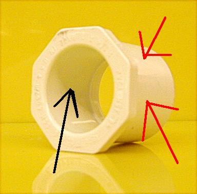

Is what I want a socket weld x pipe? (One end needs to have the 1" pipe slip into it, the other needs the 3" pipe to slid over it)

Are you trying to get a female adapter (with the threads) or just the reducer/bushing part? If you just want the reducer/bushing part then you'll need a 3" coupling and a 3" x 1" bushing that is socket weld on both ends.

This is what I need:
The black arrow = where the 1&amp;quot; pipe needs to slip into. The red arrows = what the 3&amp;quot; pipe needs to slip over.
The black arrow = where the 1&quot; pipe needs to slip into. The red arrows = what the 3&quot; pipe needs to slip over.
Sch 40 Reducing Bushing (SxS).JPG (23.22 KiB) Viewed 4459 times

if you have a pressure rated pipe on the inside and pressure rated ont he outside i see no problem with using it.

Really? That's great... yeah, both pipes are pressure rated to well over 250 psi. I guess I'll just go downtown and buy the parts tomorrow! Thanks a lot!
