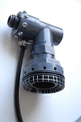

The valve components.

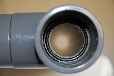

A look at the valve seat. The porting is very large for the tee size.. but it still opens faster than fast enough.

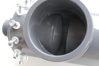

The breech with its O-ring seal, O-ring bumper (until I get some neoprene), 12 bolt holes and DFTV pilot valve.

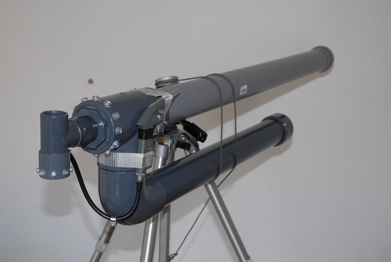

The Orange Accelerator, sitting on my tripod

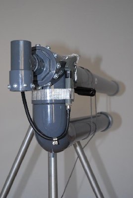

Breech end
Breech end
