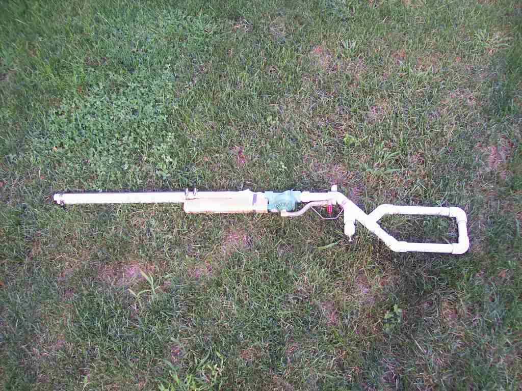

Hey again guys. I realized this site has been in a lull. Too few new cannons and too many 13 page topics about zombie uprisings. Ive been working on this shotgun for the past 2 weeks its pretty much done i still gotta paint it tho.
stock- all 3/4" sch 40 pvc
valve- 3/4" watermaster piloted by 1/4" bv.

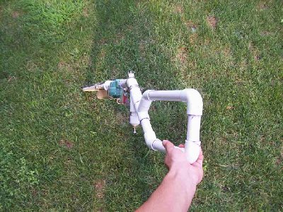

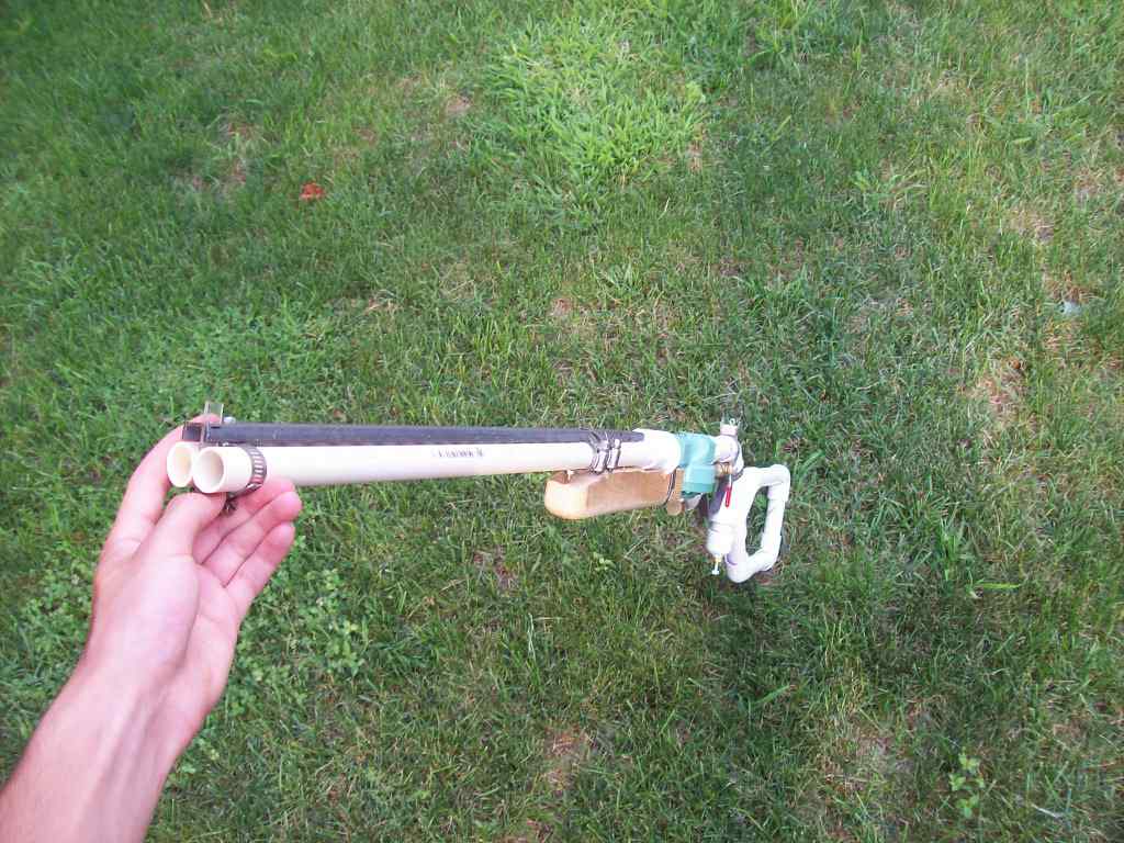

Barrel(s)- two 2ft lengths of 3/4" cpvc. The Id of which are almost presicely that of a 14 gauge. they are on a hinge and snap open to slide in/ out shells.

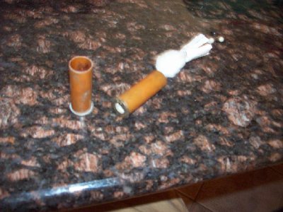

shells- 2" copper pipe lengths with washers metal epoxied on. Stuffed with cotton wadding and a paper shot cup.

Can you post some pictures of how your breach works?

Brother- it's a fitting got it off flexpvc.com. It doesnt look like its on there anymore. It's a 3/4" TO 1/2" two way manifold. ill show it in a pic.
Bigsauce- its pretty simple. It's on a hinge and The 3/4' cpvc barrels snap into 1/2" coupling pretty nicely since they are almost the same OD.
steve- for the shells i sanded down a foot of 5/8" copper, cut it into 6 2" shells and metal epoxied on heat treated steel washers.

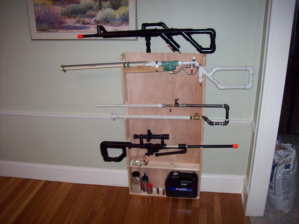

Nicely done. I like your gun rack

Could we get a more detailed pic of your breech?
