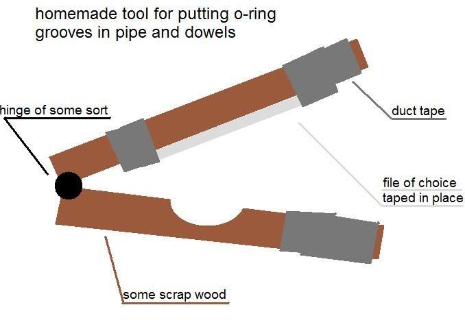

in my opinion there isn't a simple full auto pneumatic or else we'd all have them. post a mock up of ur design so u can get some real feedback. and for the o-ring grooves i had a similar problem so i made my own tool for it. it's just some hinged scrap wood with a file taped to it. u put the pipe in the groove, squeeze just enough, then twist the pipe against the file by hand. when u finish u can smooth the groove with fine sand paper or do what i did. spray it with just enough clear coat spray paint. cant get any smoother than that. it worked for me.

what ever u say. but i'm just giving him what he asked for and sharing an idea. take it or leave it.
gippeto also says that prayer is involved. doesn't sound very simple at all. also epoxy isn't always in the budget.
with the tool i made i only payed $2 for the file, $1 for the clear paint, and already had the o-rings from crap i took apart. i'd pick this over epoxy any day (unless i couldn't find the right size part to groove).

As always, thanks for the help guys. I'll probably try cast epoxy (was thinking that already but not sure if it was airtight enough) although the ghetto o-ring cutting tool looks pretty sweet too.

skyjive wrote: although the ghetto o-ring cutting tool looks pretty sweet too.
u'll find that everything i do is ghetto. that's how it is when faced with an insufficient income (i ain't got no money, dog). :lol:
