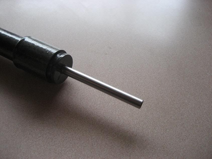

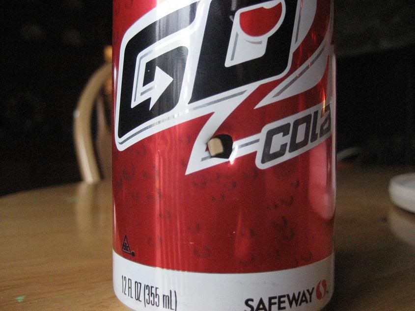

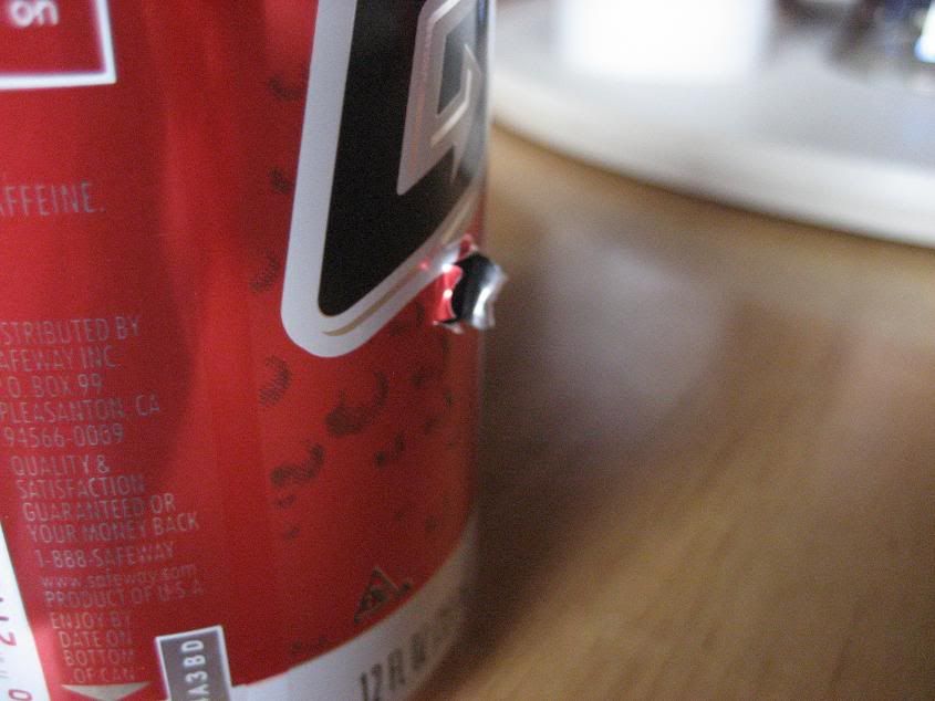

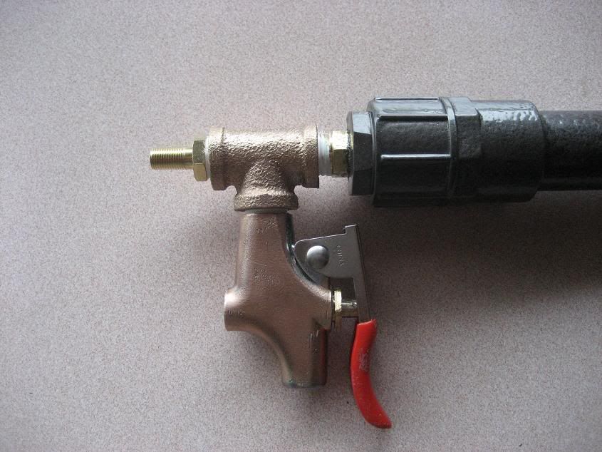

I just finished this recently, and it's a bunch of fun to plink around with in my yard. This is also my first (working) coaxial. :D
The chamber is made from 3/4" pvc, and the barrel is a 12" long piece of stainless steel pipe. I'm not sure of the exact diameter of the barrel. I just went into Ace with a couple of airsoft BBs and looked for the best fitting pipe :roll: . But the fit is pretty good. Just enough for the BB to take a second or so to roll down the tube when the piston is sealing the breech end of the barrel.
The piston is made from hot-glue, which was cast into a section of 3/4" pvc for the mold. The sealing face is a piece of neoprene, glued to the front of the piston.
The highest pressure that I've taken it up to is about 145-150psi. The coupler on the front of the gun looked a little suspicious to me. I got it at Ace hardware, in a bin that said that the couplers were pressure rated, but the plug doesn't fully fit into it, and it looked a little short in general, so I think it might be DWV. :? Anyways, here are some pictures...

That looks pretty cool what are you using to keep the barrel centered inside the chamber?

To keep the barrel centered, I cut off the top of a 3/4" plug and dremeled it down to fit inside the 3/4" pipe. I just cut out sections so it wouldn't restrict flow, and then drilled a hole in the center for the barrel to pass through. The support is epoxied onto the barrel. Sorry if the description is confusing. The support looks like this:

Very nice :) for small calibre single shot launchers I would normally recommend a smaller chamber and high pressure from a shock/fridge pump, but as a fun little plinker this fits the bill perfectly.

cool gun! wen i saw that damage piucture i think "i dont want to get shot by that!"
