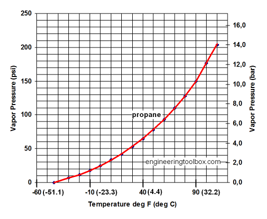

Wed May 13, 2009 7:10 pm
boom_o_matic_2.0 wrote:I'm not sure on the size of the tank. It's the kind for a gas grill. and I wouldnt have to pump it up for every shot. I'd say I could get 4 or 5 shots out of it, with a small cannon. plus to I wanted it for a bbmg. and I had no idea about pressure for that thing.
BBQ tanks are OK up to about 200 PSI if the tank is not modified.
Attached is a pressure graph for propane that shows the pressure in the temperatures they are designed for.
If you modify the tank, for example building in a larger valve or internal pump, the strength is no longer guaranteed. I'm using one for the 3 inch valve QDV I'm working on.
If you don't modify the tank, the valve can be unscrewed, but it's a real bear to get out. The hole is threaded for 3/4 inch pipe in the US for the refillable 20 lb tanks.
Pressure graph for propane
