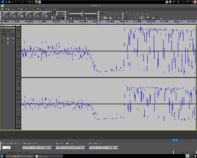

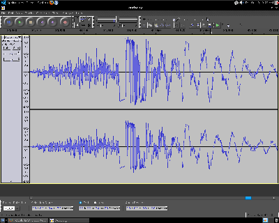

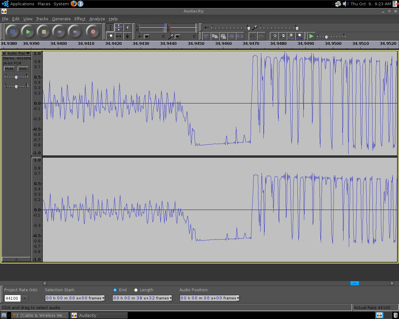

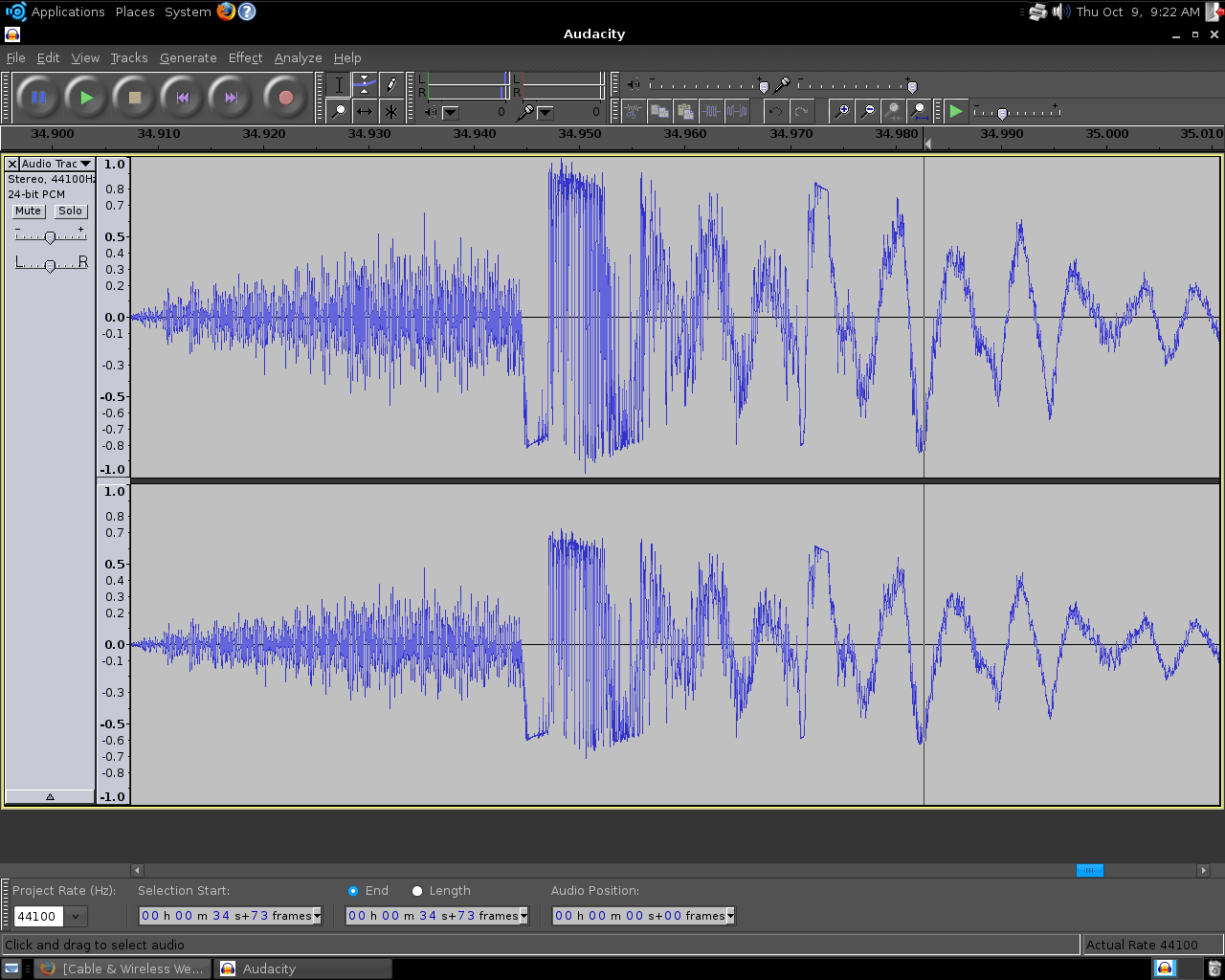

This is a common misconception. On a good close ratio barrel sealing piston valve, a little pilot volume is desirable so the pressure doesn't rise too high in the pilot when fired. A good design has about 3/4 to 85% of the face area of the piston exposed to the barrel and not the chamber. This leaves 15-25% of the piston face exposed to the pressure in the chamber. This means the pilot area pressure must drop to 15-25% of the chamber pressure to balance the closing force by the pilot with the opening force by the chamber. When the forces are equal is when the force sealing it on the barrel is gone.MRR wrote:I watched the video....
On the other hand, if you don't provide negative pressure fast enough, the piston will compress the left over air in the pilot volume and the performance will suffer.
Keep the pilot volume as small as possible and small pilot valves should be no problem.
When it pops open, (close ratio pistons do go bang even with a slow pilot), the chamber pressure opens the piston and the piston area exposed to chamber pressure now jumps from 15-25% to 100% A pilot that is too small can suddenly rise in pressure from compression and limit travel and speed. A larger pilot, for example about twice the volume taken by the piston movement will limit the pilot pressure rise to just double by the halfing the volume by piston travel. This rise in pilot pressure by halfing the volume is then double the absolute pressure.
Examples are for a 15% area piston.. 100 PSI chamber, fires at pilot pressure of 15 PSI.. or two Atm. From piston movement to 1/2 volume that's 4 Atm, or 3 bar. With the face exposed 100% to chamber pressure, this piston will snap open and remain open until the chamber is below 3 Bar pressure. This is how a QEV works. This is what makes them snap open.
Using too small a pilot volume on a close ratio valve including a QEV can hurt performance. Do the math people. Model it and examine how it works. Most QEV's will have enough pilot area when you add a short length of pipe and a trigger valve. Their pilot area is small inside the valve.
Attached again is the sound of the Mouse Musket firing. Compare it to the sound of his in the video. It has a sssssBoom. A fast pilot or very small pilot are not needed to make these work at peak performance.
My latest 3 cannons have taken this ratio to an extreme. The piston seat to diameter ratio is 1:1. To model it, there is no force on the piston when the pilot pressure is 1 atm (0 PSI) 0 bar. It requires a gentle mechanical pull to unseat it. When the valve is unseated, the piston again compresses the pilot area to about 1/2 the original volume or 2 atm or 15 PSI. This is in contrast to the 100 PSI chamber now exposed on the face. 100 PSI vs 15.. It opens all the way and remains there. As the chamber pressure drops, so does the pilot as it has a large vent. This style has the boom without the hiss.
EDIT.. Adding some info on the waveform below. The sound was recorded on the computer with Audacity. The trigger is a 1/4 inch ball valve opened slowely. this is why the hiss starts small and builds to a peak. After the peak is reached, the pilot pressure dropping caused the hiss to drop off again. This is clearly seen. When the pressure dropped off the main piston lifted and the opening is very quick and loud. The sound recording equipment clipped the signal so the boom has the flat clipped signal. Following the main discharge many room echoes and barrel resonance lingers on.
