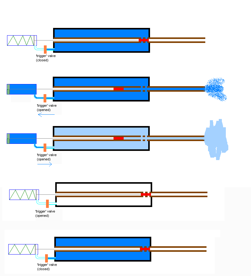

I've been thinking of combining the valve on the marshmallow gun with an aircylinder... the idea is quite simple: instead of opening the valve manually an air cylinder does it... the air cylinder is hooked up to the chamber and there is a small valve in between (for example a blowgun)...
when the valve is opened the air cylinder retracts and opens the piston valve...
the cylinder is vented as the gun fires because it's hooked up with the chamber (and because the shot takes only tens of miliseconds when the valve is still open)...
a strong spring returns the piston back to the closed postion...
the piston of the marshmallow valve could be joined directly with the bolt/loading mechanism
so what do you think of it ??

- idea.PNG (25.06 KiB) Viewed 2783 times
