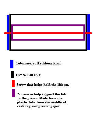

The piston is around 2 inches of 1.5" with a small plastic tube in the middle that acts as a brace for the peices of tubaware lids on either side. I put two wraps of duct tape around the piston then covered it in Teflon to help it slide easier.

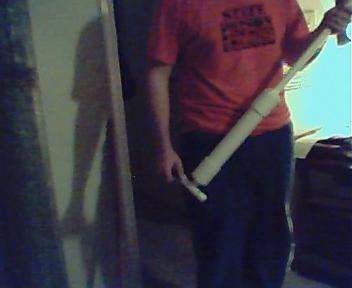

Size comparison of gun vs. man belly.

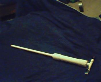

An over all shot of the gun, really bad quality, but hope it helps for the main idea.

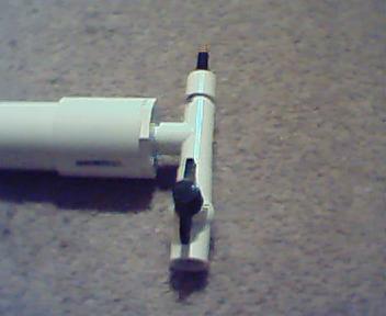

I would'nt call this the exhaust, but it's all that comes to mind. Simple layout, one side is a ball valve, other side is a tire valve. Fill and turn.

Gah, forgot to say it was one of those rubbery tubaware lids. It pushes against the barrel and seals better than I thought. I tried putting like a foam layer over the tubaware but it did'nt do much but clutter. I reget to say I have yet to shoot it, I give all my guns 24 hrs to dry but I have tested the piston to see if it will slide when pressure is put in.
So yea, the piston is very ghetto, but like I said: The gun is made of scraps and extra parts. So the overall cost was low. this way if the gun craps out, not a big financial loss.
EDIT: ***PUFF*** My happyness faded when I saw my Piston not working. It moves around the chamber with little force, but does'nt get pushed at all when the compresion starts. Could the hole I put in the front of the piston be too big and letting too much air through and not letting enough build up behind the piston to move it?
[/img]
NOTE FROM PIMPMANN22: Talk of the male reproductive organs does not belong... Although, it made me laugh.
Eh, hope this helps explain my Ghetto piston.

tupperware doesnt work all that well, try just getting some neoprene washers or some sheet rubber

I opened the gun up and took the piston out, it's still the 1.5" pipe with the tubaware front and now it's electrical taped. The front has a peice of rubbery foam that seals really well. It's from a craft section at walmart, no idea what it's called, but its a foamy rubber that you can't blow air through. Squishy enough to seal around the barrel, so it should work. Gonna re gluethe gun some time soon after I rebuild the top. Im confident it'll work though
