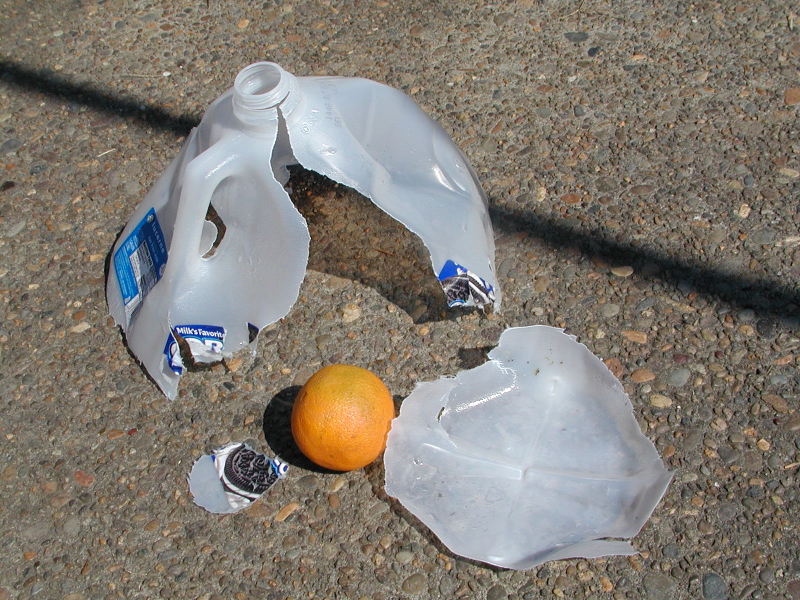

I though I would toss in a little of what to expect. I had an orange go bad, so I disposed of it by recycling it into a fine mist for the garden. As long as I was recycling, I decided to add some water. I had an empty milk jug that needed recycling.. Playtime :D
2 inch piston in QDV configuration, Milk jug full of water, add 70 PSI air and mix well. :D
Found the impact point punched a nice circle into the side of the jug. This is what I call a shot right in the cookies. :D
The explosion got everything wet within 20 feet in all directions including me. I need to back off a little.
recycled milk jug and the next orange ready for recycling  Note nice round orange shape patch.
