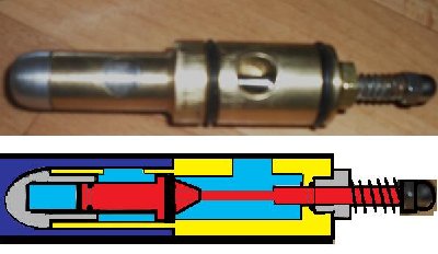

I finished the valve for my upcoming gun..
It uses the same principle as my " 35 bar pushbutton valve"
Normally a poppet style hammer valve has to overcome the pressure to open.
I extended the head into a piston and the housing into a cilinder.
The piston head seals into the bulletnose ( see picture) via an O-ring.
This illiminates the force pressure would normally excert on the front of the head almost completely.
The valve seat is only slightly larger than the piston diameter, making it pop open at the gentlest tap, yet providing massive flow.
This one offers me a 12 mm ( minus the center rod) diam. hole for the air to rush through.
Definately an improvement over traditional hammer valves and a breeze to " hammer"
This also means I won't need a massive hammer and spring to go bigbore.
Also, I think this valvedesign would be a very simple way for those with a lathe to upgrade their Crosman airguns to say... a 9mm beast! :wink:
That's why I could not keep this design from you guys.

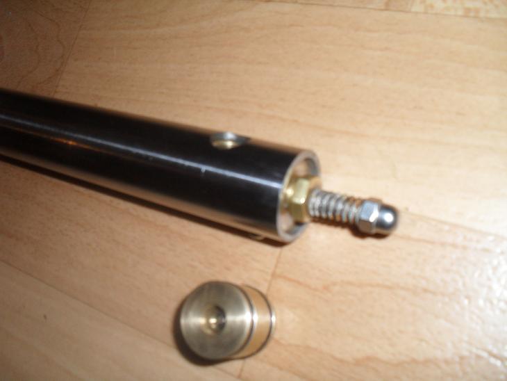

The one way valve that will be used in the cannon can also be seen in the pic.
Enjoy!

I've had nearly the same design like this in my head for quite some time but never bothered to actually build it due to the lag of 'proper' tools. :?
The only difference in my design would have been that the part on the left is actually balanced and that there would be a surface differential on the right to make it self cocking.

You know, since you need a weaker hammer to open it, that means that reloading for a semi-auto won't need much effort...

Jack...this thing could run on unregulated CO2... :D
Plenty of shots me thinks...
Just flip it under/over so a mag can be allowed from the bottom and autocock T-bolt style...
The reservoir tube could extend past the valve-striker allowing for an inline hammer ( with spring inside the tube)
Just let some gas pass the striker and...voila!
Pneumatic full auto MP5 in 9mm cal.
:D
great, now it's a spool valve :D
No!!!!!!!

The simplicity is a result of going over the design again and again, eliminating parts, reconfiguring etc.. to make it simpler and more importantly, more compact.I had thought of this particular design fairly early on but I have reconsidered it conciderably....uhmmm :roll:
I started out with a counterpiston out the front of the chamber, then a counter piston in the back, with some introgate channels providing it with the required pressure.
It's a well thought out concept..of simplicity..

No, not thaaaaat long :) but at the time when you introduced your balanced push button valve. The beauty of the concept is that you can do so much things with it, like pilot, 3-way, hammer valves and regulators.
you see I told ya - everything is a DCV
:D
Nahh but seriously - an air regulator is essentially just an air actuated 3 way valve
the simplicity is certainly there... the only question is how well it will perform as there are many things that have to be tweaked to offer both good performance and efficiency
ohh any idea what sort of loading mechanism could you use with it??

I´m sure very happy to see this :P I have been looking for hammer valve that opens with a weak spring at high pressure for a long time, good job :thumbright: I will make one simular to see how well it works :)
