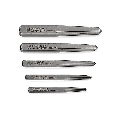

No you do not need a new one. You need to get a tool called a easy out. What it does is tap itself into the broken fitting and after you do that you put a wrench on the other end and turn it out. They cost like 5 dollars. Edit jack beat me to it thats what they look like above.

Easy Outs suck! Try wedging a chisel or flat screw driver in there and back it out. Easy Outs have a tendency to break off in the hole then your really stuck.
I can't count the amount of times I've been brought a part with a busted easy out in a broken off bolt. The main cause is not drilling the hole in the center of the broken bolt. Even done correctly they can break off rather easy cause more problem then you started with.
The only thing you have going for you is that there is all ready a hole there, and it is centered.

I broke one trying to remove a spark plug once. Only problem I ever had and have used at least 50 times...

I've all ways had better luck with this style, just don't drive them in to far and stretch out and jam/peen the broken bolt/object and make things harder on yourself...
The style I use.
The style I use.
broken screw extractor set.jpg (22.69 KiB) Viewed 5074 times
