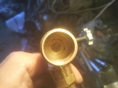

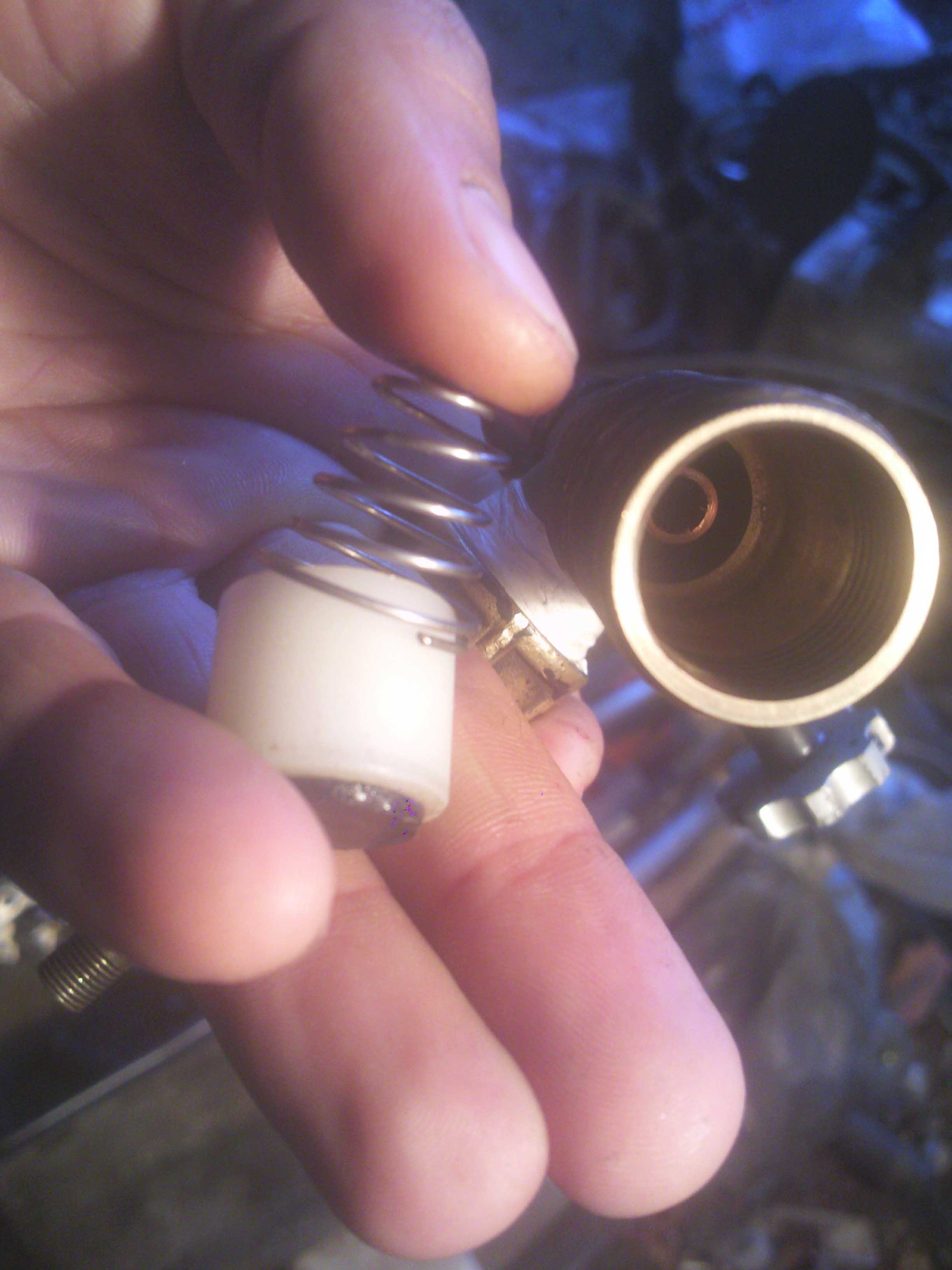

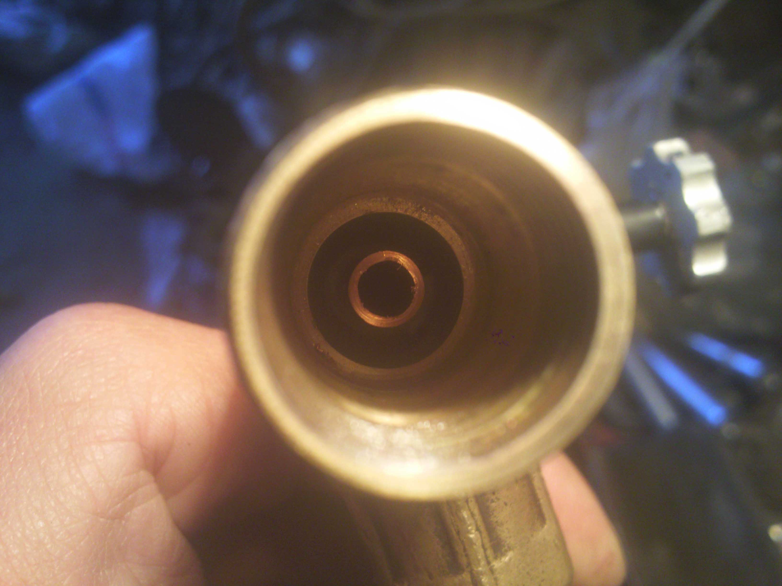

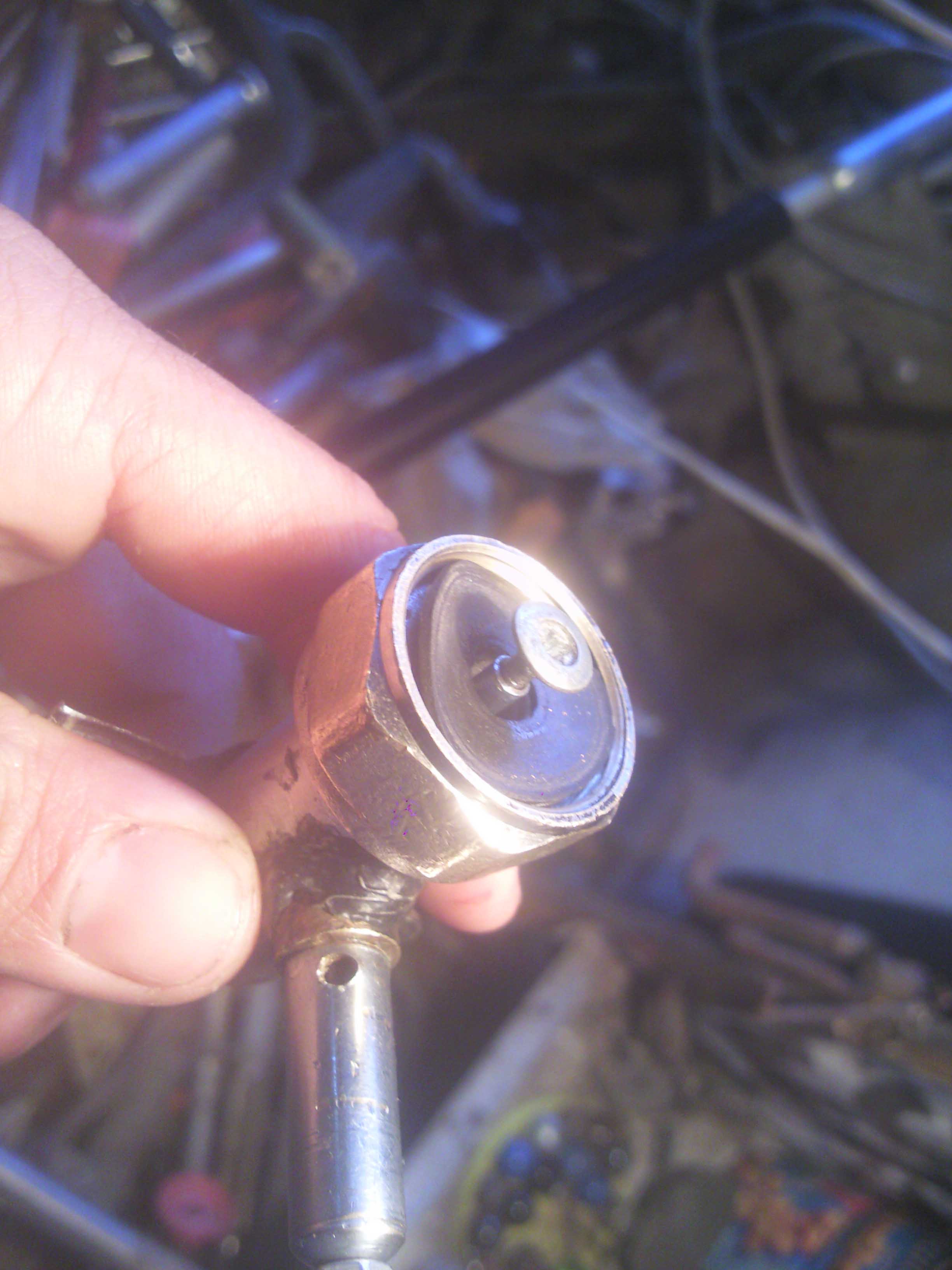

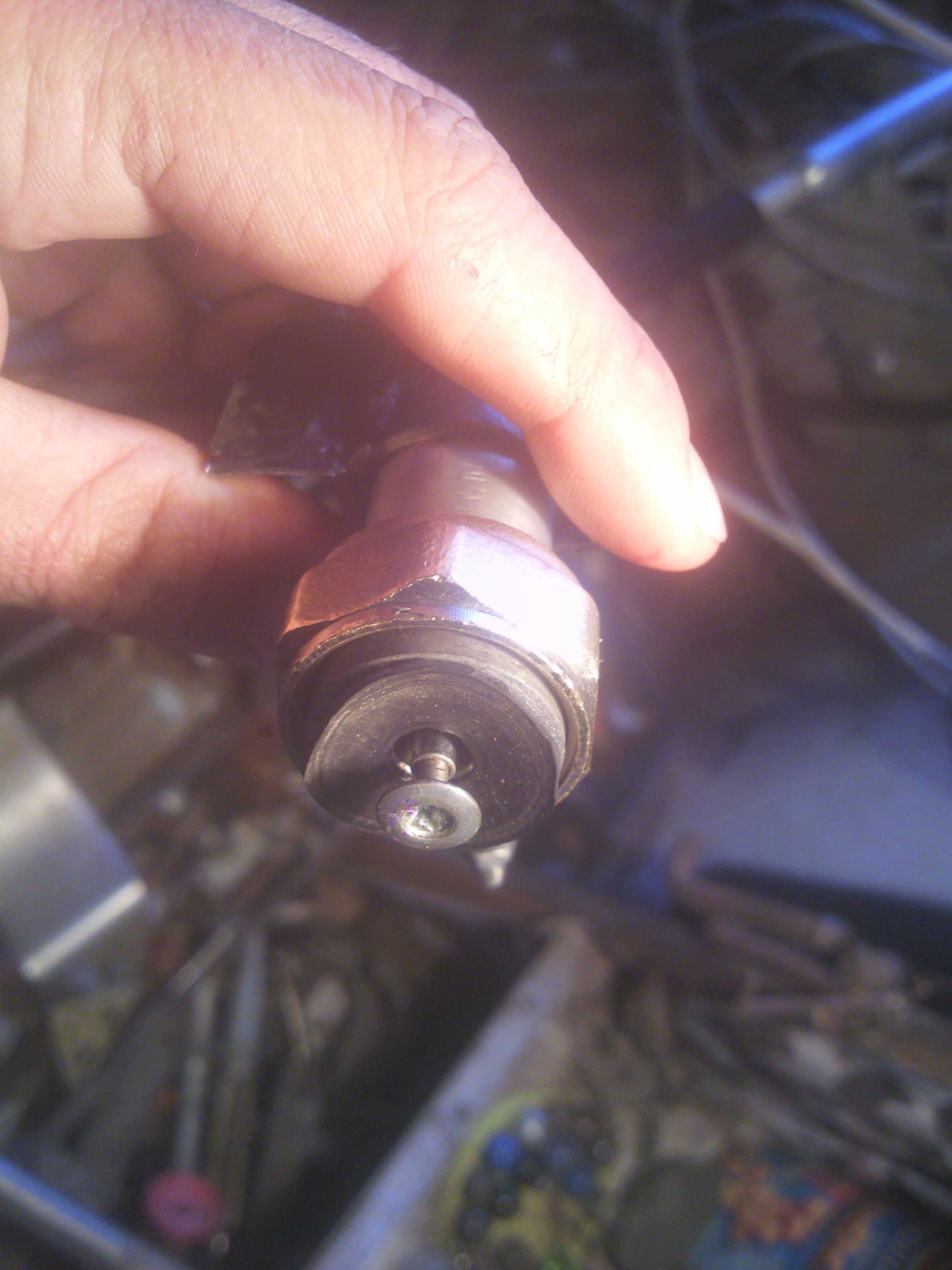

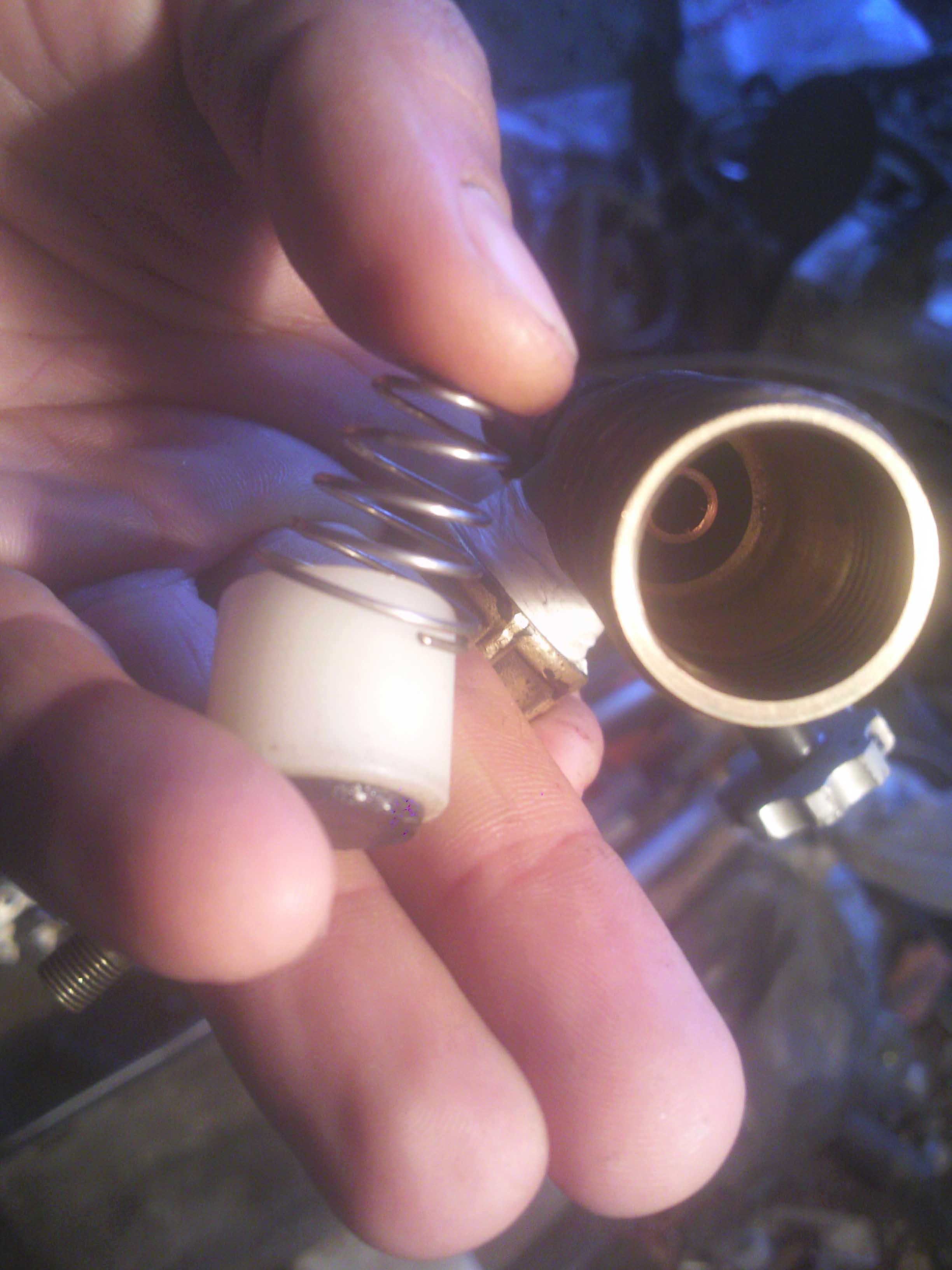

i am working on another qev fully machined so i avoid all those problems i had before, i mean a perfect piston in a perfect body. it is a multishoot.
this time the problem is that when i press to shoot that bang is not there, is only a fsssss, the bang comes at higher pressures over 10 bar( but still not that clear bang ). this fssss makes the gun very low power and performance. slower i press the pilot, bigger the fssss is. i made the piston area pretty large for the 6 mm gun, in order to decompress really easy. on previos tests i just had to touch a little the pilot's trigger and the piston responded prompt---- bang !
if you had this problem how you fixed it ? i use as a pilot the pilot from another working gun........
ANSWER : all those troubles comes from the wrong idea that bigger the diameter of the piston, faster and easier it would open, well not. Is a matter of physics. smaller it is, faster and easier it opens(since it press against 6mm pipe with lowerr power), with only few air piloted. So today i made a 10.5 mm piston(and housing) ( the previous piston had 21 mm.)for a sealing surface of 7-8 mm and i was right, now, it opens extremely easy and fast, but i will have to decreases pilot's volume( or to remake the piston larger, like 12-13 mm). but also the problem is that it pretty hard for this piston to seal the surface, no matter what i tried( only a hard spring does it).
i forgot to mention that the piston must open few mm by restricting him to travel more.
