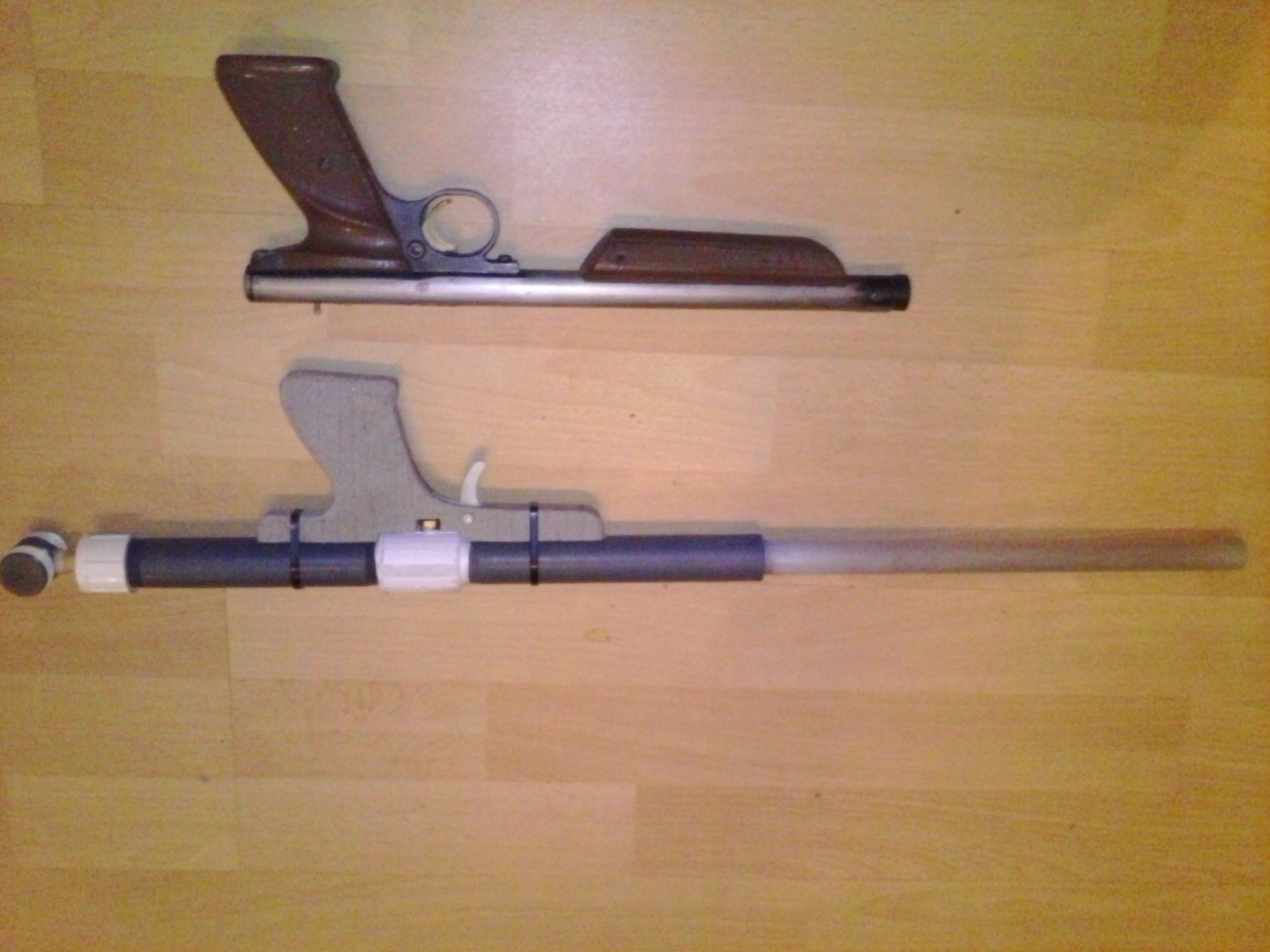

Well here it is ! Three 12" brass .30 caliber tubes in a foot long 1" chamber. Pump handle needs work, but pumps great without drawing a vacuum. A magnetic shot retainer for steel shot. Did I mention it's portable and self-contained, hehe! :D

@jack- Well this pump is the largest diameter I've made with the piston at 1" o.d. ( I use 3/4" or 1/2" normally ) because i wanted lots of air. Every stroke of this size puts 15 psi it seems so the limiting factor is your comfort and saftey. Six pumps hit the 70 psi mark on the gauge , I can do nine pumps before having to put it on my foot for leverage. Of course I respect the limits of pvc.
The pistol in the photo is my first prototype grip and trigger designed to fit all my other guns. Its engineered wood and pcv.

NICE LINK ! The internal diagrams of the trigger mechanism I have not seen before. Lots of ideas there . I'm working toward high pressure with as few pump strokes as possible , in single shot for now. This model gets 110 psi. in five strokes in a .25 caliber, enough to punch the bottom of a coke can and out the side at 20' .
I tried fixing the first photo with no luck...
