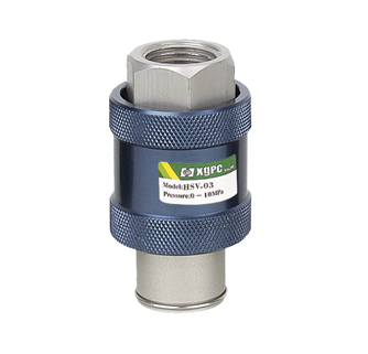

Do you think it will be safe to use a sliding valve to pressures of 350psi?
sliding valve.jpg (51.16 KiB) Viewed 5485 times
350psi on 150psi rated sliding valve and 150psi rated QEV.
Posted: Sun Oct 05, 2014 11:43 am
by ham_machine
Does anybody out there think it is safe using 350psi on a 150psi rated sliding valve, or on a 150psi rated QEV? Increasing the pressure will no doubt decrease the lifespan. I heard the diaphragm will fail first on the qev. What about the sliding valve?
Will there be any leakages on either of these, if I were to use 350psi??
I want my gun to work at 500psi, so I know it will work safely at 350psi.
Please write whether it is safe or not, so I can decide if I will use it.
Sliding valve - rated at 150psi
sliding valve.jpg (51.16 KiB) Viewed 5511 times
Qev - rated at 150psi

I use around 300psi on a QEV made by Parker rated at 100-150psi(can't remember which) and it has been absolutely fine, I took it apart as thought I had killed it, but found it was my fault as a blob of solder had gotten into it stopping it from sealing, I checked the rubber diaphragm and it was in perfect condition. I have a cheap blue Chinese slide valve from Ebay and its worked fine apart from once when an o ring partially came out, but if I remember correctly this was when I accidentally went over 300psi by a fair bit. I guess quality and tolerances vary between items and manufacturers so when first using them I started off at around 100psi and slowly increased as I became more confident, I wouldn't say it was safe to do this and may be a good idea to wear eye protection as at the end of the day you are using pressures higher than the items are rated at so better safe than sorry.

I've taken that style of QEV, a 1/4" one, up to 700PSI, at least 100 times now. It'll be fine. I've taken a few of the square QEVs in 1/2" up to the same a few hundred times, no failures at all. Slide valves are very low wear items, the O rings aren't exposed to large areas of pressure, keep them lubricated with an O-ring safe lubricant (remember oil and silicone lube destroys latex kids ;-) ), and you'll be fine.

The slidevalve might seeze up under the extra load making it impossible to move by hand.
