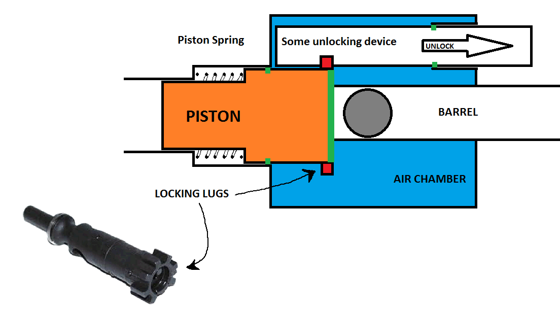

Maybe I'd build a Coax of small ratio which uses the pressure from the chamber to open and which is kept closed by mechanical locking, similar to how firearms lock their breeches. How does this system compares in opening speed to a pneumatically triggered valve?
