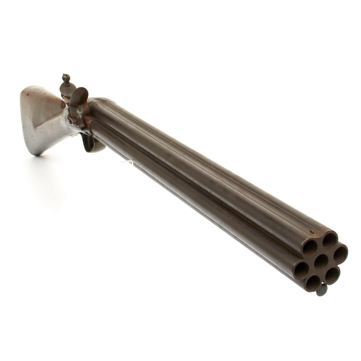

PVC Nock Gun :D

Reminds me of this:
Hate to see the worky bits concealed but ah well :) great work!
