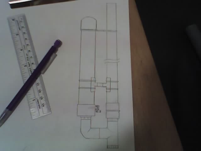

Here's my concept drawing. (Sorry, phone pic). There's no hose or blowgun on it yet.

wow... good drawing! You will be blown away by the power of even a 2" piston valve; it just OWNS sprinkler valves/ball valves/ even QEV's!
You really don't need to use a spring... I dont use one on my 4" piston valve (3" porting). You do, however, need a bumper of some sort
Kris.Is.Awesome
Posts: 72
Joined: Tue Jul 11, 2006 2:52 pm
Location: Virginia Beach, VA
Fri Aug 04, 2006 12:38 pm
rmich732 wrote:wow... good drawing! You will be blown away by the power of even a 2" piston valve; it just OWNS sprinkler valves/ball valves/ even QEV's!
BLB is machining me a piston, I hope it's going to be one hell of a cannon! If I dont need a spring, I'll just use a foam bumper- if that works.
Velocity
Posts: 1039
Fri Aug 04, 2006 1:06 pm
A barrel sealing valve, with a piston that has orings? I have always wanted to do that; it may increase performance a slight bit over a piston without orings.
Make sure that the foam bumper is really strong though. If your piston hits ANYTHING with enough force, someone is going to end up broken, whether it be the endcap or the actual piston. I have had a solid PVC rod piston crack at a 50 PSI firing with my 2" piston valve (1.5" porting)
