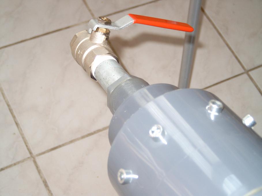

Valve: Homemade 77mm piston actuated by 3/4" ballvalve

The piston is made from a bolt and washers, some 8 mm neoprene ( also hard to find!) some MDF, and some very snug fitting perspex rings.
No need for O-rings.
It actuates like a mother, even at low pressures.

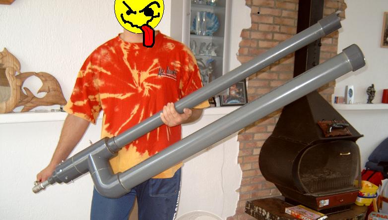

Here is the beast!!!<br />And yes, he is holding a cannon...<br />This cannon is the first cannon ever made by Sam.<br />I think he did a good job

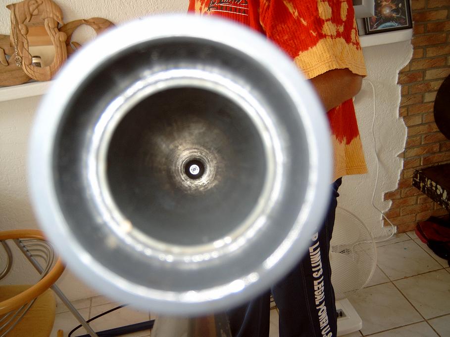

&amp;quot;Catch this!!!&amp;quot;
&quot;Catch this!!!&quot;
No comment....
No comment....

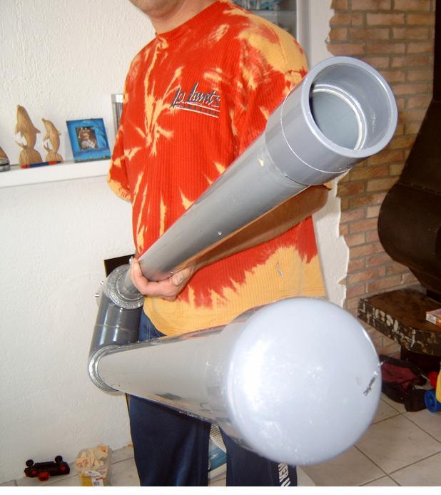

Removable back end.( To have acces to the piston)<br />Looks like a submarine don't it??

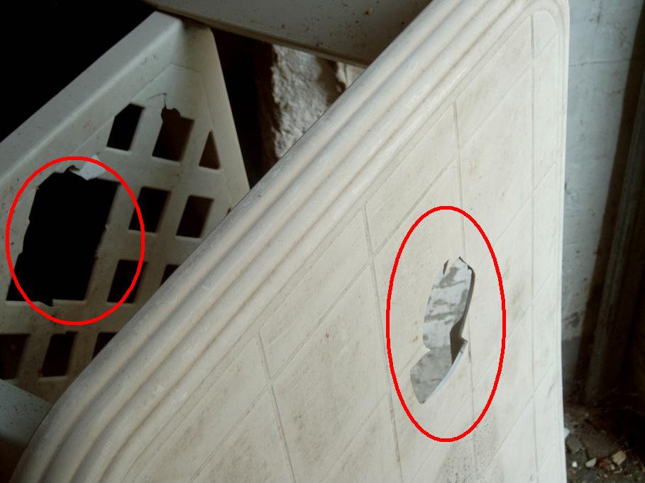

And last but not least : Some damage to a garden table with a spud.

BTW the damage was done under 2 bar!!

Wow, nice gun... the valve was constructed very cleanly! It reminds me of a supah valve in terms of size; it has a slightly larger inlet though (3.5" compared to the 2" of the supah). Same outlet though (2").
My only suggestion is to replace the ball valve with a sprinkler valve/QEV, and then use a blowgun to actuate it. Not only will this yield greater performance, it will be more ergonomic as well.
Either way, great first build!

I recommended the same thing but he doesn't want to get another pilot valve.Almost impossible to find sprinkler valves here anyway.
I found only one place that sold sh! tty ones.
It would be easier to construct a smaller piston valve from pvc parts to actuate the large one.
He feels he might get spoiled on his first cannon if he uses to much "upgrades". He likes it "raw"
He wanted to build a burst-disk gun at first.I'm glad I convinced him to build a Tee Valve!!
Anyway...the blowgun actuates the valve insanely fast.
I was not expecting it to work this well.It gives a good pop and good recoil at 2.5 bars so who's complaining?
