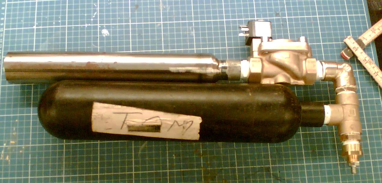

Here is a picture of the confetticannon we made at work this week. All part are rated 20 bar or more (the chamber is rated 250 bar), we are using 7 bar to fire confetti. All parts are 3/4'' copper pipes exept for the barrel wich is 2'' steel. It has a electrical solenoid vent.
The background is cm grid.

The chamber looks like a CO2 tank.The weakest part on it seems to be the valve.
Very nice clean and compact construction.
Maybe the valve can be modded for pneumatic actuation.

The bad thing is I won´t be allowed to fire projectiles with it, the good thing is I get payed to make it.
We won´t rebuild the valve into pnemeuatic action, as an electrical trigger is escensial on stage.
