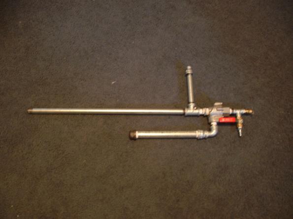

This is my automatic marble gun.
I've had it built for a while now, I was just waiting on a camera.

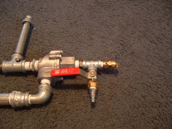

The operating principle is simple: you connect an air compressor or other high-flow, high-pressure system to the gun with a female quick disconnect, and then open the ball valve. The source fills the chamber through the pilot, and when it hits 90 PSI, the pop-up valve triggers and pilots the 1/2" Q.E.V.

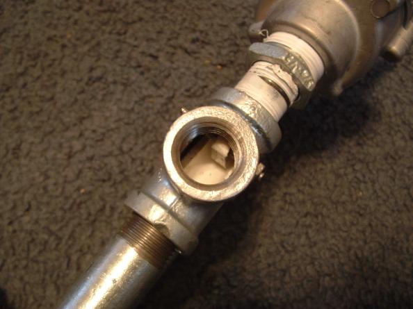

The feed system is a paddle-interrupter type. With each shot, the air-flow pushes up a paddle which interrupts the flow of marbles into the "chamber" and allows only one to fire. I also sleeved half a piece of 1/2" PVC into the tee for easier feeding of marbles into the barrel.
Here's some more pictures...

I didn't record the firing rate on this video, (I recorded 4.33 hertz on an initial test video on my cell phone), but if I take 4 hertz and convert to RPM, you get exactly 240 RPM.
The air compressor I'm using is a small little 100 PSI 2 gallon one. I'm actually seriously considering getting a higher pressure one with a larger tank volume, but I dunno if it's worth it. At my dad's house we've got a larger 33 gallon one that works at 155 PSI. I'm betting when I hook it up to that sucker regulated down to 100 PSI, I could empty clips all day long with little or no interruption.
The only pop-off valves I could find locally are the higher ones, (125, 150, etc...), so I ordered a 90 PSI model off McMaster along with the 1/2" Q.E.V.
It <I>might</I> work with a sprinkler. I have only owned one sprinkler valve in my lifetime, though, so I wouldn't really be the guy to ask. I <I>think</I> it might work well because you'll be filling from the chamber, (I guess), with the pop-off on the pilot. That way, you're 100% guaranteed the chamber is completely filled when the pilot hits your target pressure.

Yeah, I though a little about the feed mechanism. I saw a few elaborate ideas, but eventually I chose the simplest because I didn't want this thing to break or anything gay like that. I'm actually considering increasing, (however slightly), the surface area of the paddle to help me to use larger magazines. I figured out today that when I used a larger mag, (like my 1/2 x 12" pipe nipple), the misfires at the beginning get more common, because the paddle doesn't have enough force inherent in it to push the marbles back up into the magazine. Increasing surface area may remedy this problem.
I also wanted this to be a "plug and play" cannon. 90 PSI was a good choice for me first of all because my compressor here can only go up to 100, (giving you 10 PSI buildup for shooting). I assumed all compressors could go AT LEAST to 100 PSI, so I chose 90.

It WAS a little difficult to work with a design inside such a small tee. Eventually, though, patience and concentration got through, (it took a few tries and test fits), and I got the thing built.

Here.
This mod adds more surface area, which should make misfires like the one in the video nonexistent.

It's just a paddle that swings up when you shoot to stop the flow of marbles.
