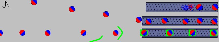

Ok here is why you have to wad a paintball to get anything that could be called accuracy
The first one is what would happen if you had rifled barrel that a paintball would fit tightly in.
The second is why any paintball gun, smoothbore or not, would be inaccurate if the paintball doesn’t fit tightly.
And the third is the solution.
NOTE:
The picture is by no means accurate, if the rifling were really that steep the projectile, no mater how tight fitting, would not take to the rifling, you’d be lucky if that’s all that happened.
NOTE:

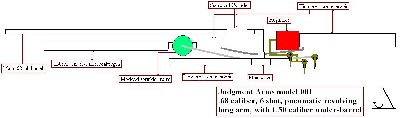

Ok I thought I’d state my plan, better late than never.
Here are the specs:
Barrel: ¾ inch SCH 40 PVC, rifled, rate of twist = 1 in 18 edit: 1 in 41, length = 36 inches.
Low pressure/main chamber: 12-14 inches of 1 inch SCH40 PVC.
Valve: undecided, most likely a chamber sealing piston tee valve.
High pressure reservoir: approximately 16 inches of 2 inch SCH40 PVC.
The part I’m requesting help with:
The high pressure reservoir is filled to about 100PSI and is regulated down to about 30-40PSI, some how the regulated air is fed into the low pressure reservoir, and the valve is opened firing the arm.
The problems:
1. The filling of the low pressure reservoir.
2. opening the firing valve with out dumping the high pressure reservoir.
Ok that’s all I’ve got for now, questions, comments, and complaints are welcome
Thanks

search around.. some place funded by the military found that the best fit is a paintball that touches the barrel on two sides. pour flour down your barrel, slide a ball through it, and if there are two lines opposit of each other you got a good fit.judgment_arms wrote:Ok here is why you have to wad a paintball to get anything that could be called accuracy
NOTE:

Or, backspin the paintballs.
If you give them backspin, then they'll both get a little more range, and they'll be damned accurate.
Rifling has the issue that you lose muzzle velocity to convert that into rotation. Backspin does the same, but to a lesser effect (I think anyway).
Rifling also needs more work to get it right - if you have your rate of twist just a fraction too low, you'll lose lots of accuracy. Spin is less picky.
Ragnarok fitted a spin inducer to his latest pneumatic cannon (via his twist lock muzzle system), and it's now possible for him (or me for that matter) to hit a 1' square target with a steel ball bearing - at over 100 yards.
