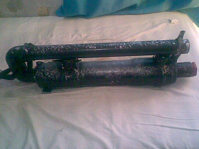

hello i just signed up and i have a blast cannon this is the picture
(see picture attachment)
the bigger pvc is 4"x50cm and the barrel is 2"x50 cm piezoelectric ligther disposable (yes if the trigger breaks or runs out i just remove it an place another one in five minutes)
material is pvc hidraulic use heaviest class(and more expensive)
now the question is
there is a way to use propane instead caprice hair spray? how i can put a valve for propane of the portable stoves?
how i can put a sigth laser or something and it be alienated with the barrel?
i have fired:potatoes,oranges,mangos, empy axe cans ,etc anything that fix on it
other thing i am from mexico so excuse if i have mistakes writing in english

if you go to the combustion section there is a sticky on how to make a propane meter. it isnt hard.

http://www.spudfiles.com/forums/how-to- ... t7234.html
Es en Ingles, lo siento.
(Sorry if that was poorly written, but I Spanish is not my native tongue.)

Welcome to spudfiles(shouldnt be sayin that as i am vey new too :lol: ). First of all if you arent using propane as of now do not use hair spray it really gunks up your chamber really badly and isnt very powerful either. But since you do want to use propane there are many places to look for it likehttp://advancedspuds.com/propane.htm,http://www.burntlatke.com/lp.html, and even this http://www.spudfiles.com/forums/pvc-pro ... t1872.html. Hope this really helps. By the way really nice cannon im likin the paint.

Well maybe if your looking for other powerful ignition fuels you could try to use the stiociometric (spelling?) mix of H2 and O2, which is the components of water seperated. You can do this with a electrolysis machine, which you can find a new version of killjoys right here. But i would not use it on this cannon only because it doesnt have a metal chamber. This stuff is powerful so it needs a metal chamber because even pvc can break but i have never heard of the pvc you are using so i wouldnt know if its safe on that. But hey im learning spanish now so maybe you can help me :D
La foruma aqui es muy bueno. Hay mucho informacion del spudguns. Es muy divertido aqui. Vas aprender mucho informacion. Pero si tu necesitas ayuda, nosotros podemos ayudarte.

it is great but i am not sure it will be too powerful still for hidraulic pvc
but can be really fun to use in ballons bombs
