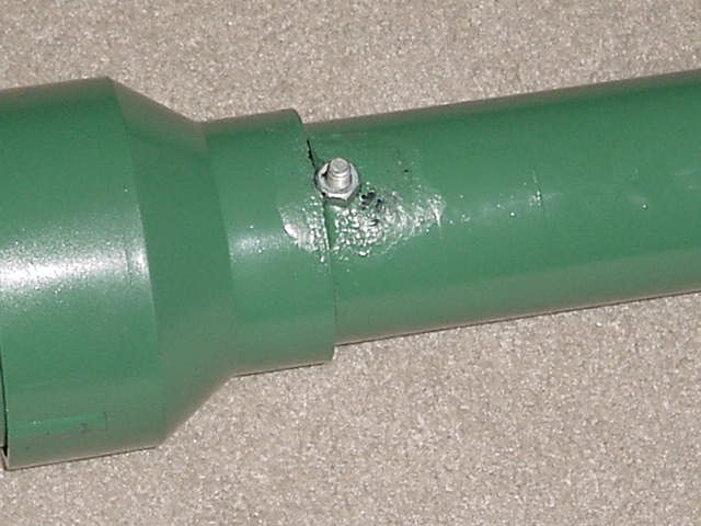

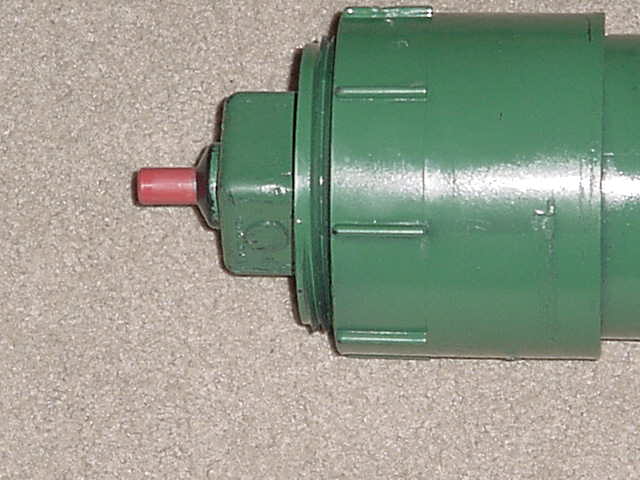

- the bbq lighter setup {built into male drainage cap}
- picture of a bolt into barrel to stop spud from entering the chamber
- my final spud gun

I wish people would stop posting such standard cannons. A word of advice on your ignition, endcap ignitions have been known to shoot off the back because of the thinner PVC. After your reducer get a male and female adapter, (male on the barrel) and you can screw the barrel off, stab a potato into the breech, screw it back on, no ram rod needed. The male adapter on mine cuts potaoes nicely and airtight.

I do agree though, get a different ignitor though, becuase that could blow out on you.

ignition in endcap= bad idea

i have my ignition in end cap..i use a coleman lantern sparker and ive fired it about 25 times using axe spray and no problems with the ignition in the back..
