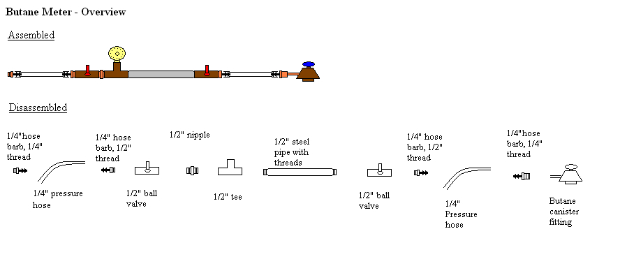

Hey all, I'm really new to combustion cannons so i would like to upload my design and specs just so it can be looked at and improved (don't want to have to rebuild it). I have done a fair bit of research and have spent a bit of time planning this out, I am merely posting this so it can be checked and i also have a few questions. I hope you guys can help out :D
BCC1- 1st Butane Combustion Cannon
First of all I am fueling this on butane. Simply because it is easier for me to get, cheaper for me to buy, and from what i can tell you need slightly less fuel volume than propane (3.8% compared to 4.2%). It is going to be co-axial (barrel only runs 200 mm into chamber however) and I am using a fuel meter to inject the butane. I am using a barbecue piezo to ignite the chamber as a stun gun is hard for me to get. I'm not sure if a spark strip will work with a piezo (maybe not enough voltage?) but I am planning on testing a 5-gap spark strip with 1mm gaps. The launcher is is threaded where the barrel connects to the chamber so I can breech load it and it also has a threaded cap on the end so I can turn on a computer fan that i plan on inserting into the back. The butane cannister hangs below the chamber. The butane meter is hose clamped to the side of the chamber.
On the attached diagram of the butane meter its shows a 'butane cannister valve'. This is basically the top valve that i got off a portable butane-powered blowtorch. It shows on the diagram that a hose barb will connect to this valve; i will most likely weld this on. If the pressure hose fits nicely to the butane cannister valve i will simply clamp the hose straight to the valve, but it is not an issue.

4)Meter: My maths isn't great, but after doing some for my meter i got the result of filling the butane meter to 9 PSI. First of all this doesn't make sense to me as the atmosphere pressure is 14.7 i think, or does this mean 9PSI on top of the atmosphere pressure? Or maybe i need to reduce my meter volume to increase this pressure (i already have the parts for a 90 cc meter volume but i can change if need be)?
I have attached some of the basic sketches i did on paint (mainly for myself) but i will put them up anyway. Sorry, i think all the names for the parts are wrong but i originally just made these diagrams for myself but i hope you are able to understand them anyway!
Any input/ideas/improvements/answers would be much appreciated!

I'm probably wrong here, but my basic maths suggests to me that your fuel mix is a little lean, with 32ml of of fuel in the chamber (2.2%). However, I haven't worked with meters at all, so I could be wrong. I'm

Ahh, I thought your meter volume was 53.2, so I used that in my calculations. That was correct, but your new chamber volume is 785cc, so you'll have to re-do those calcculations
That is the correct volume of fuel, but I don't have enough information about your meter to check the pressure you need to get that value. (meter volume * meter pressure = volume of propane introduced to chamber).
The value you're getting (9psi) is measured in PSIG or gauge pressure. It is called this because it is read from a gauge calibrated to 0psi for atmosphere. Therefore, the pressure in your meter is 9psi above ambient pressure.

Biopyro wrote: The value you're getting (9psi) is measured in PSIG or gauge pressure. It is called this because it is read from a gauge calibrated to 0psi for atmosphere. Therefore, the pressure in your meter is 9psi above ambient pressure.

Yes that makes sense about the PSIG. I think i will be changing my meter volume so that it fills to about 20 PSI anyway.
I am about to do some testing on a coathanger and my BBQ igniter. Sorry everyone about the confusion of me calling it a 'piezo' as i have heard them called 'BBQ piezo's' before in Australia. I will take into consideration that taking a few mm off is a good idea so i can be sure of a spark. I will get started on testing my igniter soon.
