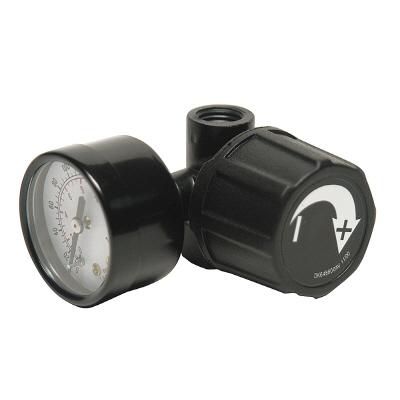

I am going to build a advanced spud gun. I will be using metered propane. Most guns I see on here have a psi gauge built into the regulator (i.e husky regulator), but then they throw on a extra gauge on the meter pipe. If you already know the psi post regulator, why waste the money for a gauge on the meter?

- husky.jpg (10.63 KiB) Viewed 5341 times

Many regulators with small diaphragms have poor repeatability. Many regulators have a pressure gauge that reads the maximum pressure it can put out.
Using a lower pressure gauge on the pipe permits better accuracy. For example, the gauge shown above may read to 100 PSI. Using a 30PSI guage on the meter pipe will make it much more easy to set a precise 25 PSI if your meter is using lower pressures.
Okay thanks guys. I am going to add a T of the second ball valve with a secondary pressure gauge.
