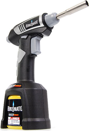

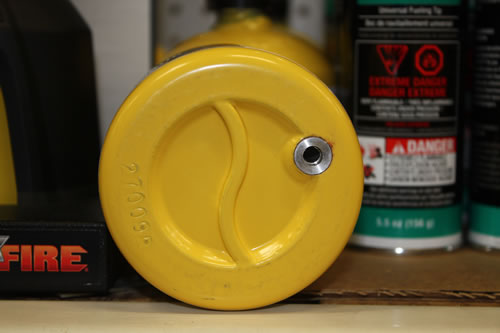

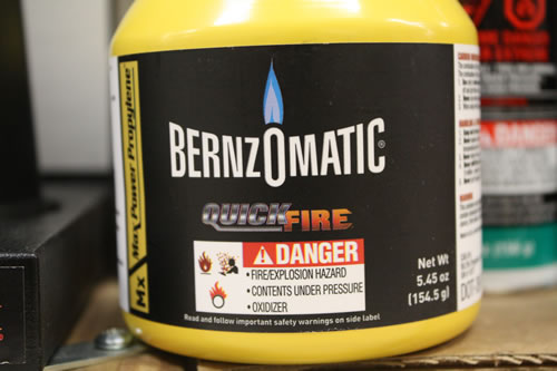

I was kicking around home depot (buying my new Bernzomatic torch head to cut and thread for my injection system) when I spotted this. This is the new Bernzomatic Quick torch. That little can on the bottom is the question. After doing some digging I've discovered the torch runs on propylene. Fine. Except if you look at the canister, on the base is an "S" that is probably as thick as the the walls of the canister that runs across the diameter of the tank. (think of a yin yang) It looks like the tank is divided into 2 compartments. Here's the kicker, the sticker on the side of the tank says "Oxidizer" across the bottom . . . I couldn't find anything on the oxidizer though and I dug around for quite a while. Ok so the question is who here knows something about this and who has used it for an on board direct inject fuel? Anyone? Bueller?[/img]
See how it looks like the tank is divided?

OXIDIZER
OXIDIZER

http://www.bernzomatic.com/quickfire-hand-torch.aspx
Looks like a standard type torch though exactly where the air inlet is still unclear, must be back on the body somewhere. The web site appears to say that the cylinder just contains propylene and not oxidizer.
Wed Jun 02, 2010 8:16 pm
The air inlet is in the normal location in the torch head, It is covered by the plastic. There is a grill on the side of the plastic (3 slots) to let air in the housing.

Ok so after some of the responses (one suggesting I mis-read Oxidizer as Oderizer . . . . c'mon, I'm not looking at a Febreze can) I went back to Home Depot to take pictures of the tank which I poasted to my original. As you can see, the label clearly says "OXIDIZER" and it appears the tank is divided as I originally stated. I know it's a tank of propene / propylene, but it's not JUST a tank of propene. I would really appreciate answers / responses from anyone who knows for sure what the Bernzomatic people did with this for sure. I have no doubt the torch works great, thats not what I'm asking about. I'm asking about the divided tank and the oxidizer. If you're not sure, please don't suggest I'm mistaken, the pics are there. If you have used this for a cannon please let me know.

MikeNice wrote:Ok so after some of the responses (one suggesting I mis-read Oxidizer as Oderizer . . . . c'mon, I'm not looking at a Febreze can) I went back to Home Depot to take pictures of the tank which I poasted to my original. As you can see, the label clearly says "OXIDIZER" If you're not sure, please don't suggest I'm mistaken, the pics are there.
The pictures are there now but when I posted they were not.
The data sheet which I looked up for you before posting has absolutely no reference to the yellow propylene can containing an oxidiser but it has been odorised - "stenched to allow detection of leaks" as it says.
Read it yourself: http://www.bernzomatic.com/Portals/8/Re ... 20msds.pdf
Found in the top of this section: http://www.bernzomatic.com/resources/msds-sheets.aspx
Also the news release for the blowtorch: http://www.bernzomatic.com/newsroom/ber ... torch.aspx
Tank doesn't look like it's divided, it has one filling port and one outlet port like a normal can.

POLAND_SPUD wrote:hmm that's interesting... I am guessing it's not pure o2 but rather N2O
Doubtful.
If I read the vapor pressure table for propylene correctly, at roughly room temp its going to be at roughly 220 psi. Nitrous would be more like 800 psi. The pressure differential would make for a very odd pressure vessel that would be difficult to optimize.
edit: Wait.... Unless it wasn't a side to side split but rather one tank inside of the other. That could be interesting....
edit2: LOL... THat's what I get for doing unit conversions and such in my head. Short version is that looking at the MSDS for Quickfire tanks....
It shows pressure as 160 psi @ 68 deg
But further, it makes no mention of an oxidizer. Propylene and propane. That's it.

The tank doesn't look like it has two sections, the pattern on the bottom is there either as reinforcement or as a grab point for the machinery that processes the tank. Perhaps as a grab point for spinning the cylinder as the valve is installed.
Propylene is a very weak oxidizer and perhaps that is why it has the "oxidizer" label on it.
