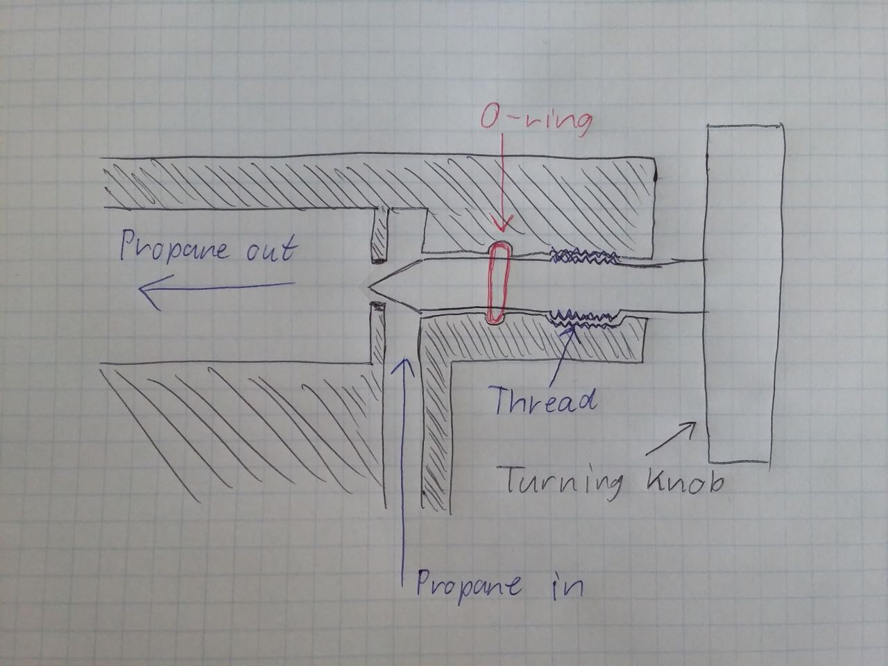

I need to build a propane valve that can be actuated by an RC servo. This means that the range of travel of the controlling surface is limited and the force needed to open and close the valve should be low.
Due to the travel limitation, I cannot use a screw type valve (see attached drawing) where it's just a brass needle pressing onto a hole when closed.

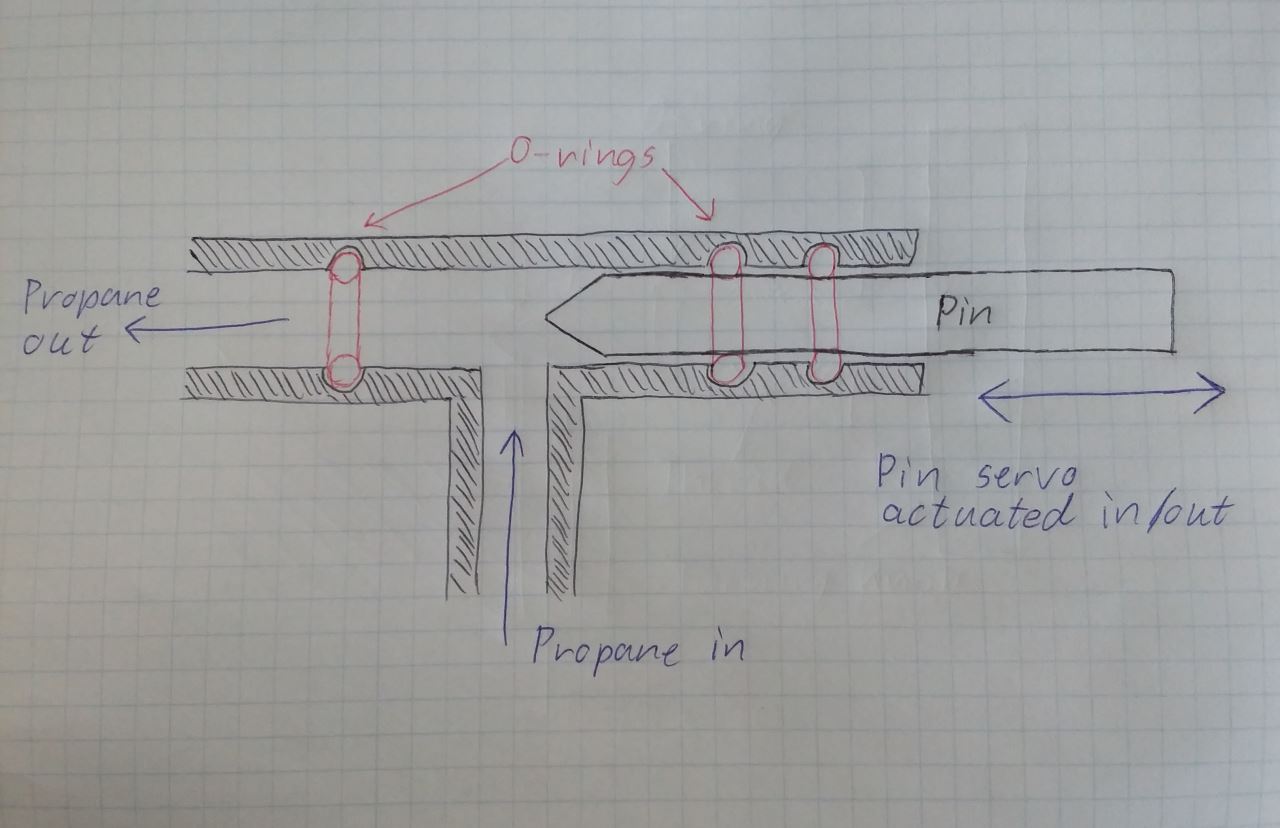

I have been thinking about a design as attachment number 2, simply a pin that goes into an O-ring and seals off the propane flow. Would this work? Or would the O-ring be a weak link? What would happen if liquid propane would enter by accident, would it block up the movement of the pin into the O-ring? I would of course have something that keeps the pin from shooting out to the right.

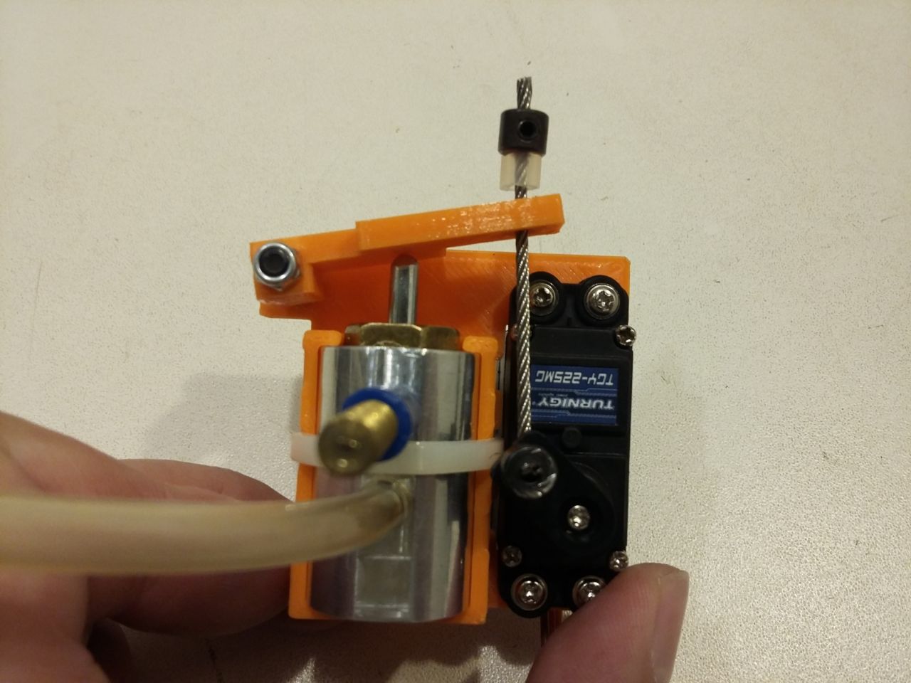

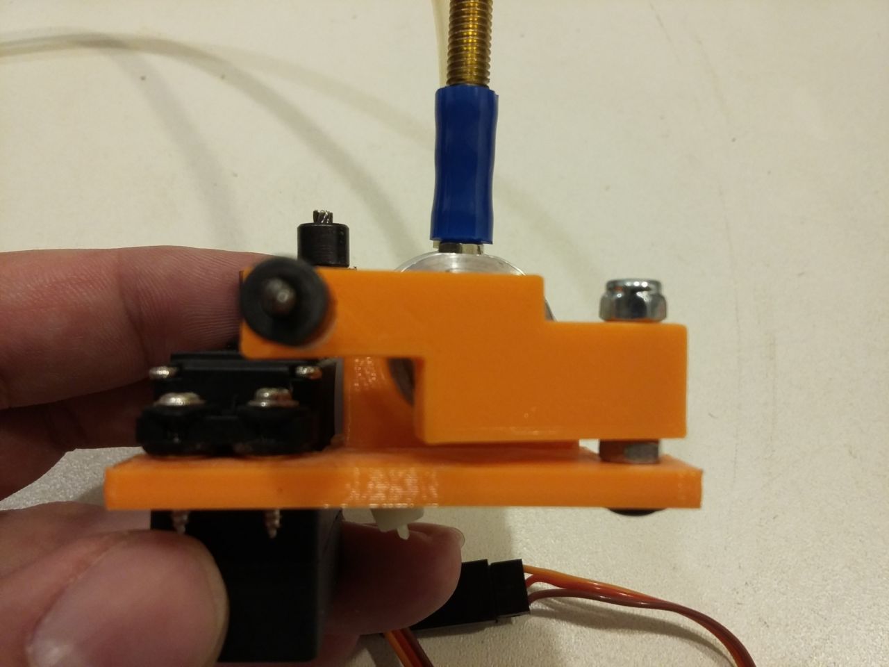

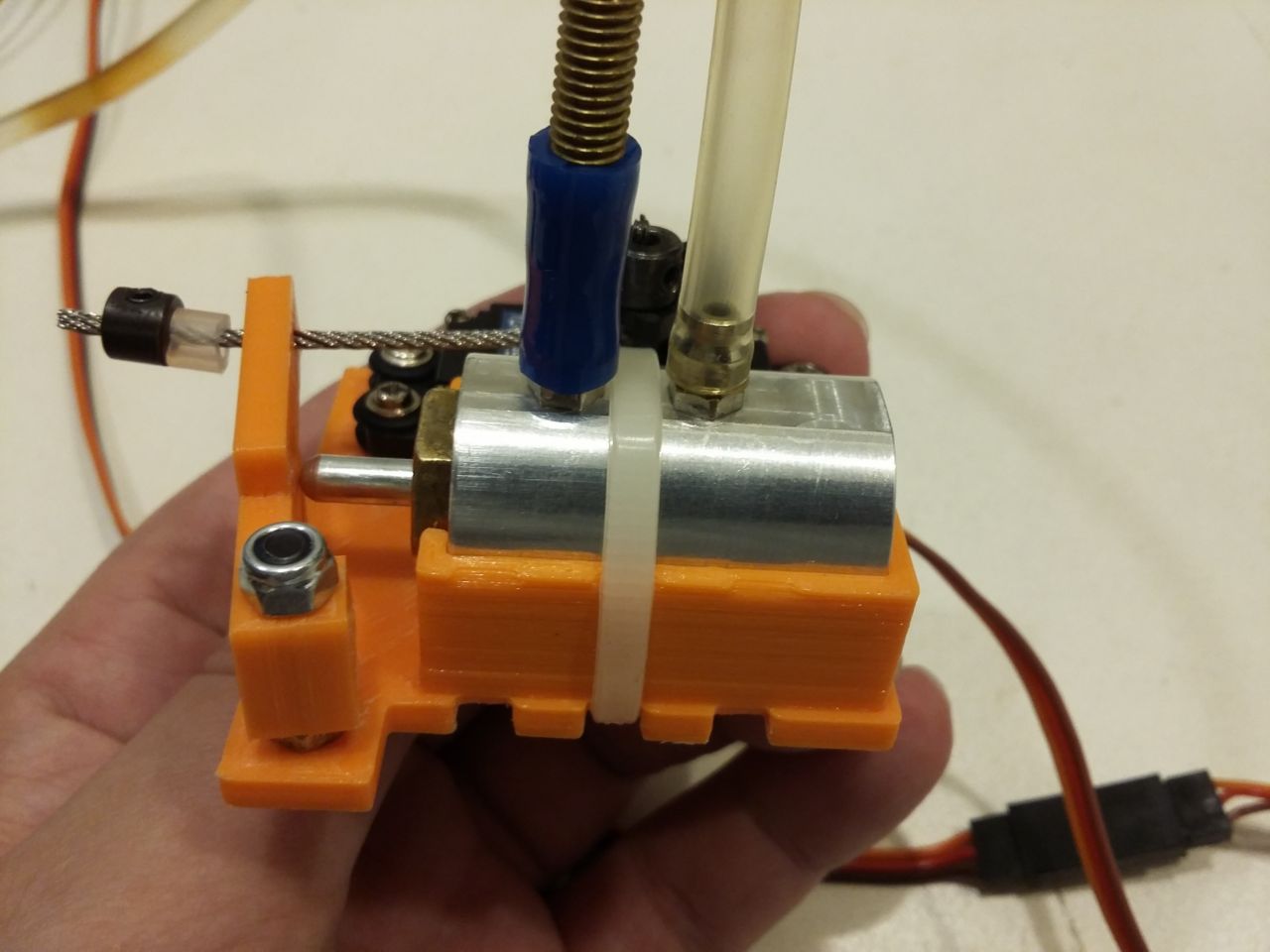

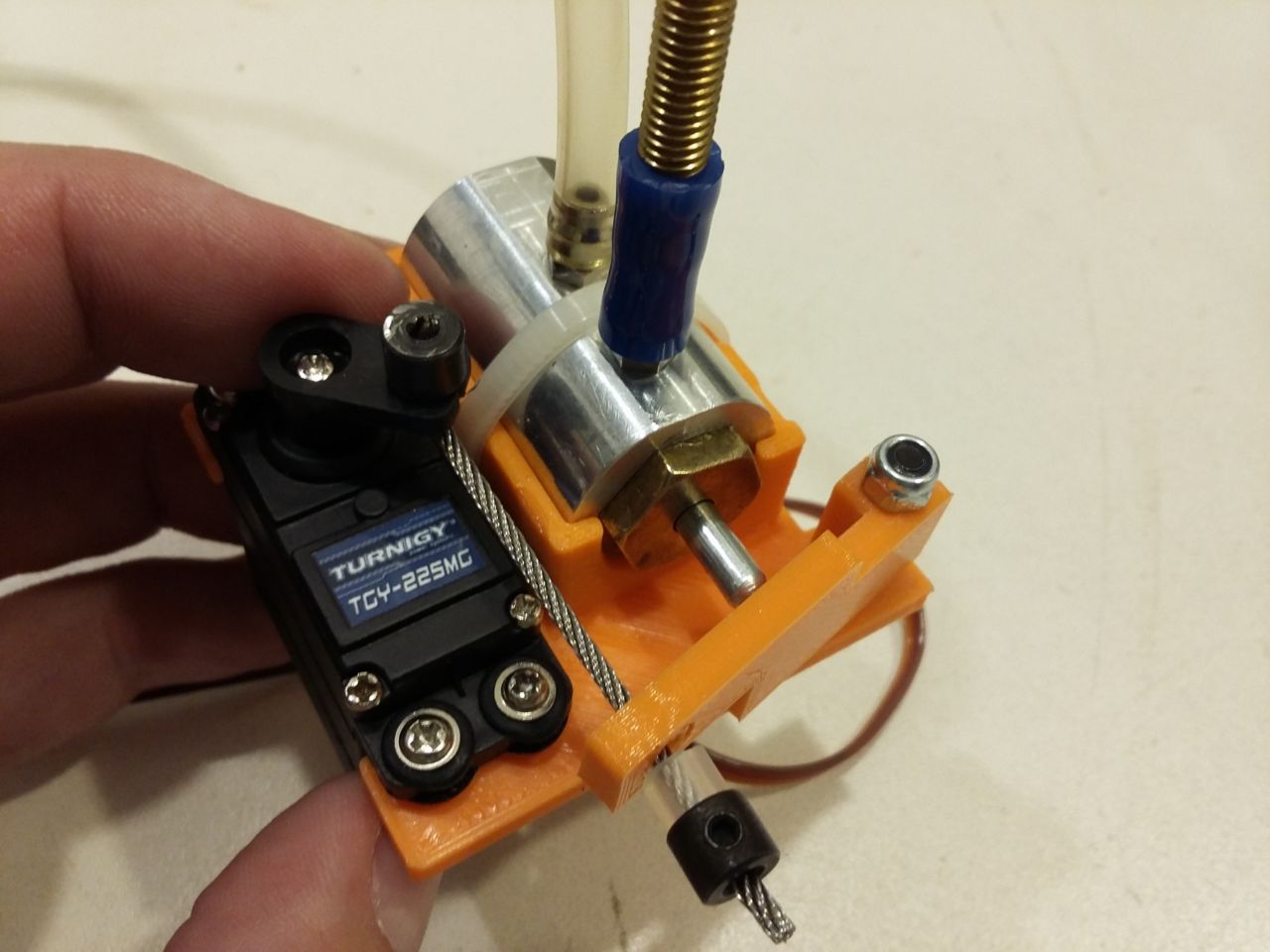

Now I just need to figure out how I want to connect it to the RC servo. It needs to press straight down on the tap. I put a return spring inside the valve, so I only need the servo to push down. But with the pressure from the propane tank applied, it takes 2.5kg pressure on the tap to activate the valve. The servo I got for the job is a 3.5kg rated servo, so it should be able to do the job just fine if I do the mechanical link the right way.
Futterama
Denmark
Posts: 110
Joined: Sun Oct 11, 2015 1:19 pm
Wed Aug 03, 2016 3:57 pm
Now with servo operation :D
The servo has no problem opening up even with a inlet pressure of 8 bar.
Total weight: 73g. I am very pleased with the result. Will fit my sound cannon project perfectly.
