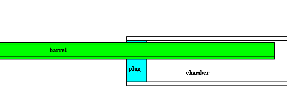

What I am suggesting, metallover, is something like this. Easy to build, but requires some sheet pvc (or alternatively a lot of epoxy). You have plenty of room for spark gaps, and you can even put one or two smaller fans below the barrel.
You can also keep your breech loading without using a wye, which are not pressure rated by the way.
This is the same way my first combustion was constructed, the only difference was I didn't push the barrel in that far.

As far as your coax setup, I like the idea. How difficult is it to get the barrel in straight? Also, how large a fan or fans would fit under the barrel, assuming standard pc fans?

I got some major work done today. I assembled the chamber and battery. The battery is a POS [my first one] but the chamber turned out pretty good. It is just the right size.
The stun gun and fan are still in the mail. I hope to have them by the end of the week. I also hope to be online by next weekend. I haven't decided how far the barrel will go into the chamber, or even if it will be a coaxial. I also cut the barrel today.

Oh jeez... Hmm the chamber is 10" of 4"pvc. That's about 2057cc
The barrel is 7' of 1.5" which is 2704cc
The calculated C:B ratio non coaxial is .751:1. If I did a coaxial the C:B ratio would probably not change too much. I would have it only part way in, maybe 6". That would take around 200cc's from the chamber. It would change to about .676.
I wanted my C:B ratios to be pretty low because I shoot spuds and the C:B ratio doesn't matter as much. Also because I live in town and I do half of my shooting there,so I'd like it to be quieter.
In a nutshell-
Regular - .751:1 C:B
Coaxial - .676:1 C:B (half coaxial - 60% length of chamber has the barrel in it)
The camlocks are 2". I had to bore the crap out of the peice that goes on the barrel. The one that attaches to the chamber took some boring, but not too much. The camlock systme works flawlessly.
1)I'd recommend using a vice and clamps to get the barrel straight when the glue is drying. If the hole you drilled is nice and clean it'll line itself up.
2)With a 4" chamber and 1.5" barrel you'll have a bit over 2 inches. You can easily get a 50mm cpu fan in there.
You could potentially get 80mm fans in if you mounted them horizontally. A bit trickier but it'll mix the fuel just as good.
